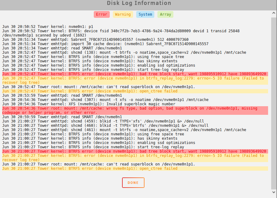

Restarted the VM and boom - the entire box crashed and showed a segfault on the separate unRAID terminal monitor I had connected. I hard re-booted and the system came up, but now cache drive won't mount and is giving the following errors:
FYI - pic is somewhat confusing. I manually tied to play with the fs type as I thought my cache might have been xfs and unRAID was trying to mount it with btrfs, but changing and re-spinning up the array had no effect on the core problem.
I'm attaching the system logs i have. Any help is greatly appreciated!
tower-diagnostics-20210630-2101.zip
There are some recovery options here, first one to try for this would be the one with "ro,notreelog,nologreplay".
Thanks! that was helpful.
I *think* my initial drive corruption issue is resolved. I was able to mount the problem nvme drive with the command you recommended. I ended up installing an extra nvme drive in my server, mounting it, and was able to copy over the data from the old drive. I then installed the new drive as the only cache drive and it's working as expected with no errors. My dockers are back up luckily!

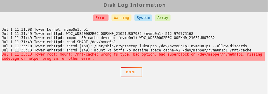

Unfortunately I spoke too soon.
Things were mostly good, and I was watching the dockers and all of the sudden I started getting errors about "read-only file system" in the docker logs and they wouldn't start back up.
I tried to reboot and now the completely different NVME drive is acting the exact same way as the first - won't mount. Nothing working again...
A new log should be attached.
tower-diagnostics-20210701-1136.zip
No clue what to do now. I could keep re-building the drive as earlier, but I'm afraid this problem is going to keep appearing. I was trying to get the win10 VM to work... maybe there is something crazy wrong there that keeps causing this, and if I just nuke the VM and start from scratch it might be ok?
There fs corruption again:
Jul  1 11:33:13 Tower kernel: BTRFS error (device dm-5): bad tree block start, want 204523241472 have 7362525906269925244
This is a new filesystem? If so you likely have a hardware issue, start by running memtest.
