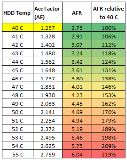

16 hours ago, FreeMan said:
Finally, I found a Tom's Hardware story from 2007 reporting on a Google Labs research paper (404, I couldn't find it at the Wayback Machine, maybe it's me).
You can find the google paper here: https://research.google/pubs/pub32774/
Other studies:
http://0b4af6cdc2f0c5998459-c0245c5c937c5dedcca3f1764ecc9b2f.r43.cf2.rackcdn.com/23104-fast16-papers-manousakis.pdf
http://www.cs.virginia.edu/~gurumurthi/papers/acmtos13.pdf
From the link above (AFR -Annualized failure rate):
Edited by Lolight
