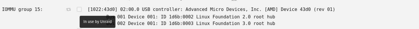

This is a screenshot from System Devices with a USB-controller that should be unused but the checkbox is greyed out and displays this message:
164026538_Screenshotfrom2021-07-0617-35-01.thumb.png.f07dee3ddd0bd0203249875ab2c987d1.png

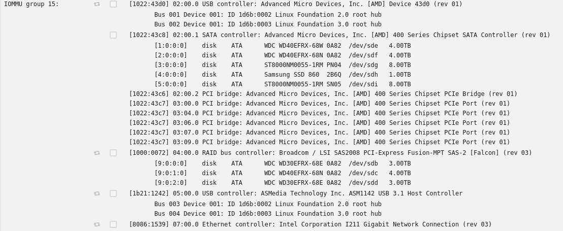

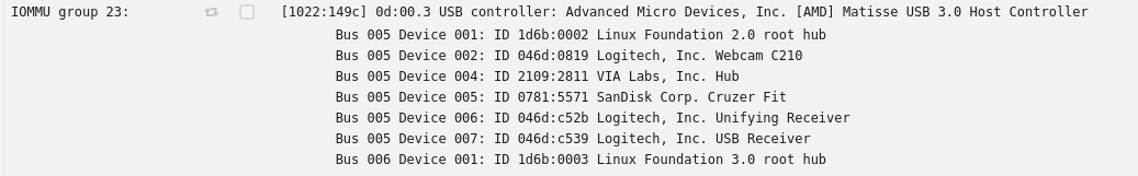

Group 15 is being used by Unraid.  Group 23 is the controller that shouldn't be used at the moment.
This group is also in use by unraid, probably because the unraid USB-key is located here. Before the CPU-swap, parts of group 15 was the one I passed through.
Before the swap I could pass through just the USB-controllers in this group.
Are you using acs override? group 15 contains a lot of things, you need to split this group.
ACS Override has indeed been switched back off. Turned it on again and everything is back to normal, thank you!
