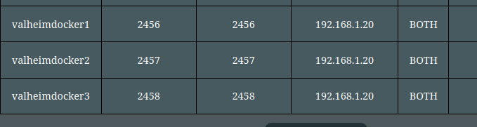

  1. Well not that minimal compared to other dockers I guess As I understand it NAT-loopback should be on by default on ASUS-routers and cannot be turned off (setting removed in some semi-recent firmware) My ISP does not use CG-NAT (89.XXX...) and the IP is only refreshed when the fiber optic media converter is restarted (so very rarely). I have duckdns setup in case of a refresh (that address does not work either) Loopback works for other sevices (e.g. Plex) I have tried both the IP and the DNS-name, from both a Windows and Linux (Manjaro) desktop. Both can connect locally but not cannot find it in the server list. Is there any logs I could provide to help?
  2. Im trying to create a Valheim server but I cant connect to it remotely. I can connect locally no problem using "add server" in game. Docker config looks the same as kjpolker, advanced docker view shows the same (bridge, minimal CPU and RAM usage). Port forward should be correct.
