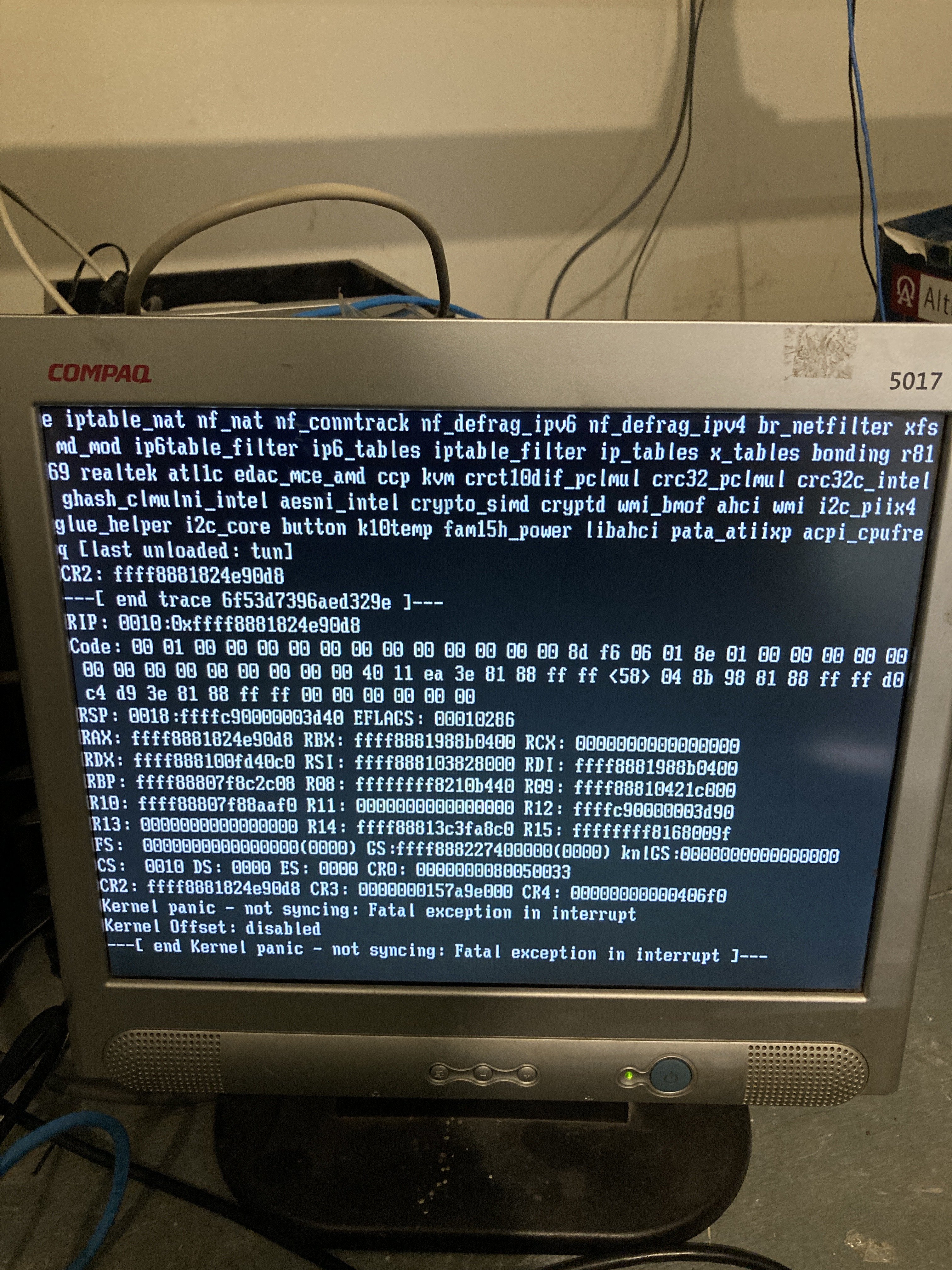

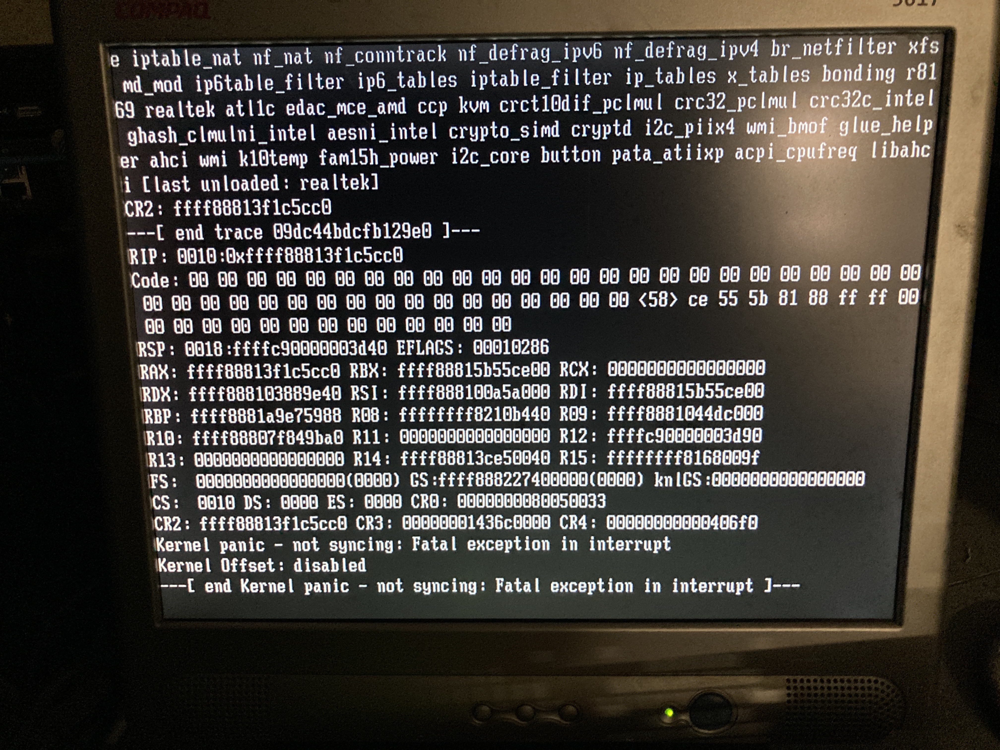

Abut every week I am getting a Kernel Panic that is taking down my system. What's the best approach to try to solve this problem. I really do need to get my server to a place where it's reliable!

Jul 13 14:07:54 ADL-Server kernel: macvlan_broadcast+0x10e/0x13c [macvlan]
Jul 13 14:07:54 ADL-Server kernel: macvlan_process_broadcast+0xf8/0x143 [macvlan]
Macvlan call traces are usually the result of having dockers with a custom IP address, more info below.
https://forums.unraid.net/topic/70529-650-call-traces-when-assigning-ip-address-to-docker-containers/
See also here:
https://forums.unraid.net/bug-reports/stable-releases/690691-kernel-panic-due-to-netfilter-nf_nat_setup_info-docker-static-ip-macvlan-r1356/

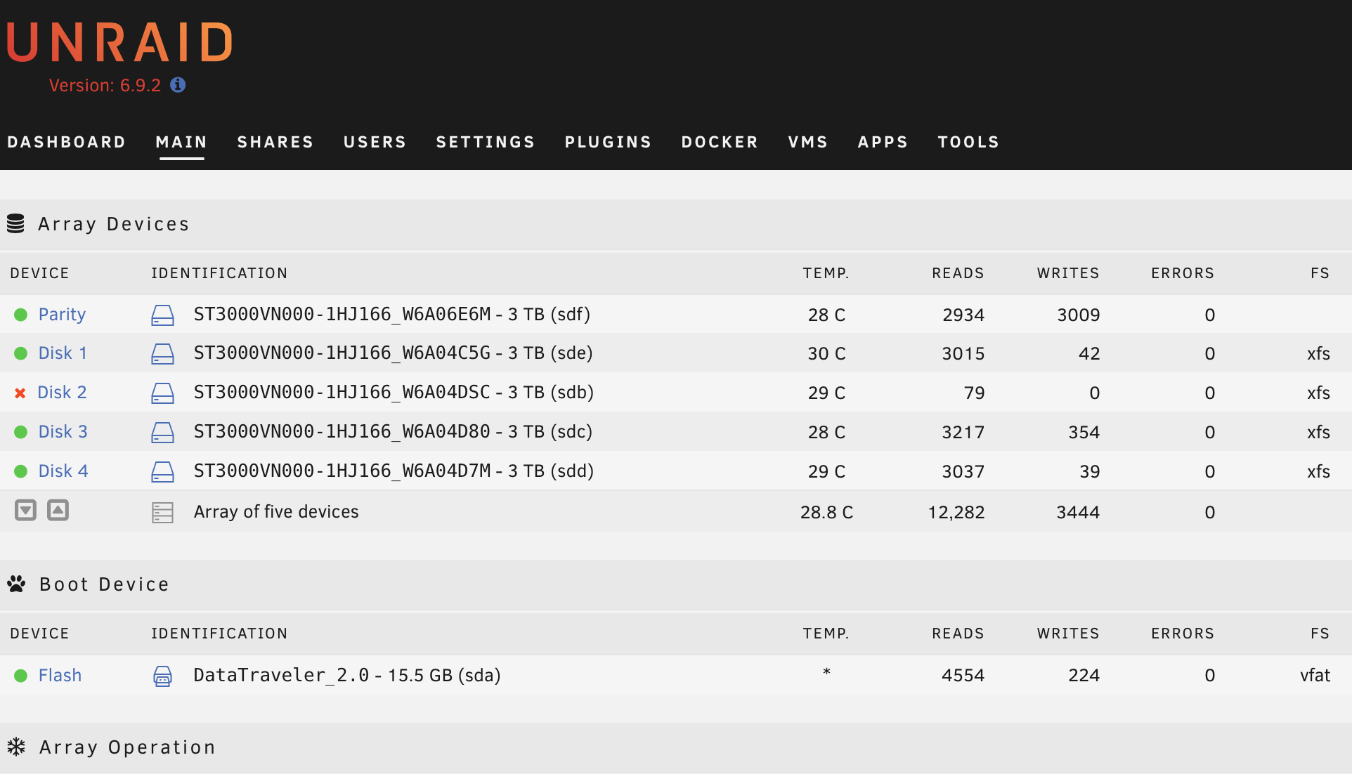

But I sill seem to be having a lot of ATA errors. I did replace all my cables with new ones. now my disk2 is down and I don't know why?I tried to reformat it but it did not bring it back. I am getting a bit stuck with Unraid. I am noticing files vanishing from my Shares with is alarming to say the least.
That will happen if you do this:
I tried to reformat
Formatting is never part of rebuilding a disk, there's a big warning about that.
There are none on the diags posted.
