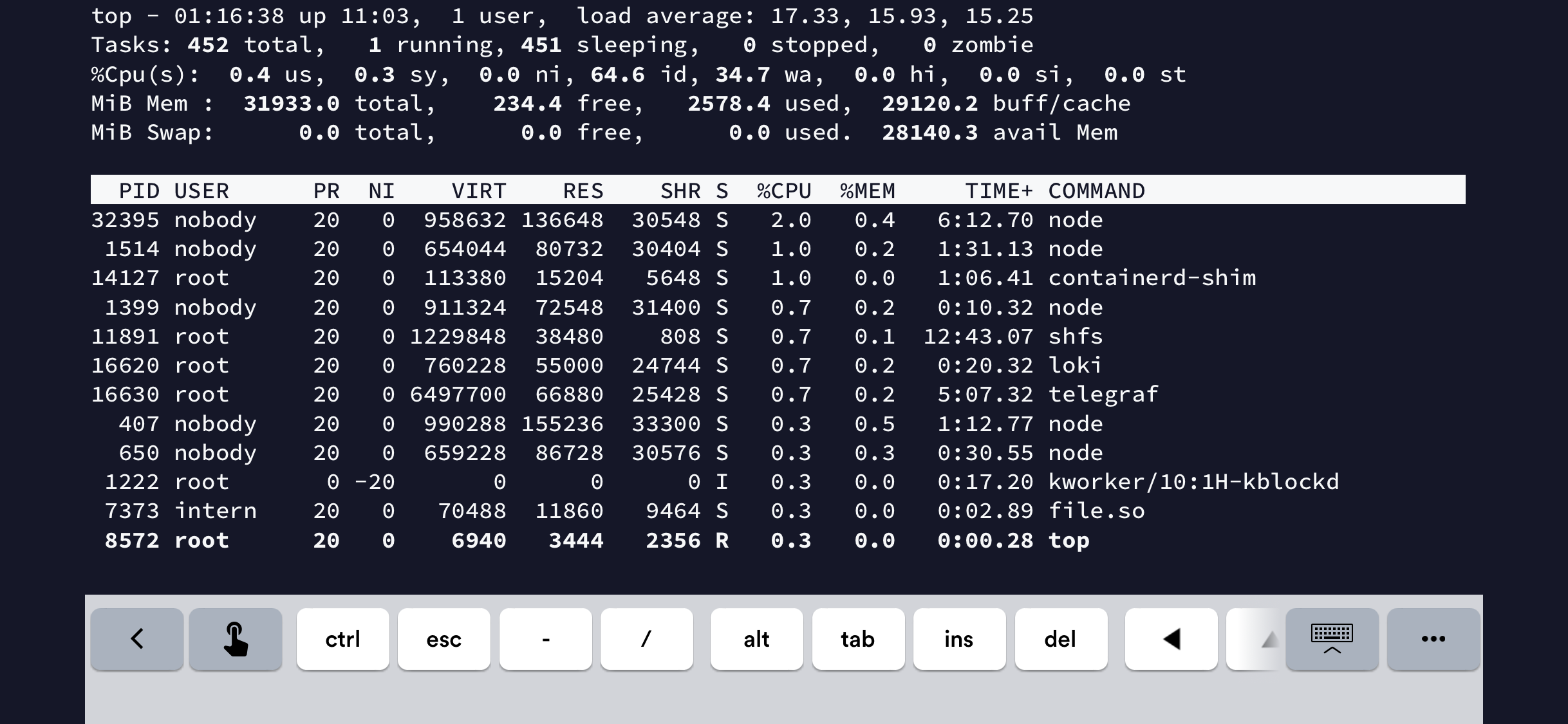

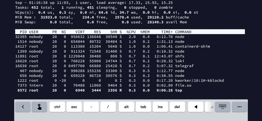

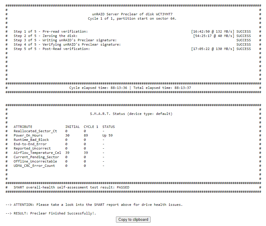

July 19, 20215 yr Hi all, i have problems with high IO-Wait Times (30-50%) when writing to the Array directly. Write Speeds at the first 10 Seconds are at 170 MB/s then it drops to < 10 MB/s. Sometimes it also hits 0 Byte/s for a couple Minutes. The Problems are on SMB, on Terminal, on VM´s, on Mover and on Docker Containers. Reads from the Array are fine, no IO-Wait. Writes/Reads from Cache is also fine. I tried so far: Added a new Disk to the Array - PreClear Speeds at >20% was also very low. New SATA-Cables BIOS Upgrade Disk Shares instead of User Shares reconstruct write On the Screenshots you can see the Speeds while copying files from the Unassigned Device to the Array. Also I took a Screenshot from "top" and from the PreClear report. I hope you can help me with this. Thanks! Setup: Gigabyte Technology Co., Ltd. W480M VISION W American Megatrends Inc., Version F20 BIOS dated: Mon 19 Apr 2021 Intel(R) Core(TM) i5-10400 CPU 32 GB RAM 3x ST8000DM004 in Array (1 Parity, 2 Disks) 2x CT1000MX500SSD1 in Cache 1x ST2000LM007 as Unassigned Device Edited July 20, 20215 yr by Reclaim
