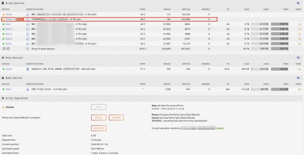

Gee, I just tried it and it's letting me do it for a parity device.................................
Are you differentiating Parity from Array and Pool even thought Party devices are listed under Array?

As a backup parity as in this case is it reasonable? Could you explain what my expectations should be from the following?:
Obviously in this case I have ONLY used the USB drive for Parity and not Storage, but I was going to add storage to USB 3 as well at some point... But yeah, I'd like to know what I should expect with this and then perhaps we can expand discussion to storage after we're more clear on the big picture and any bottlenecks or problems that might arise that relate to performance or otherwise...
