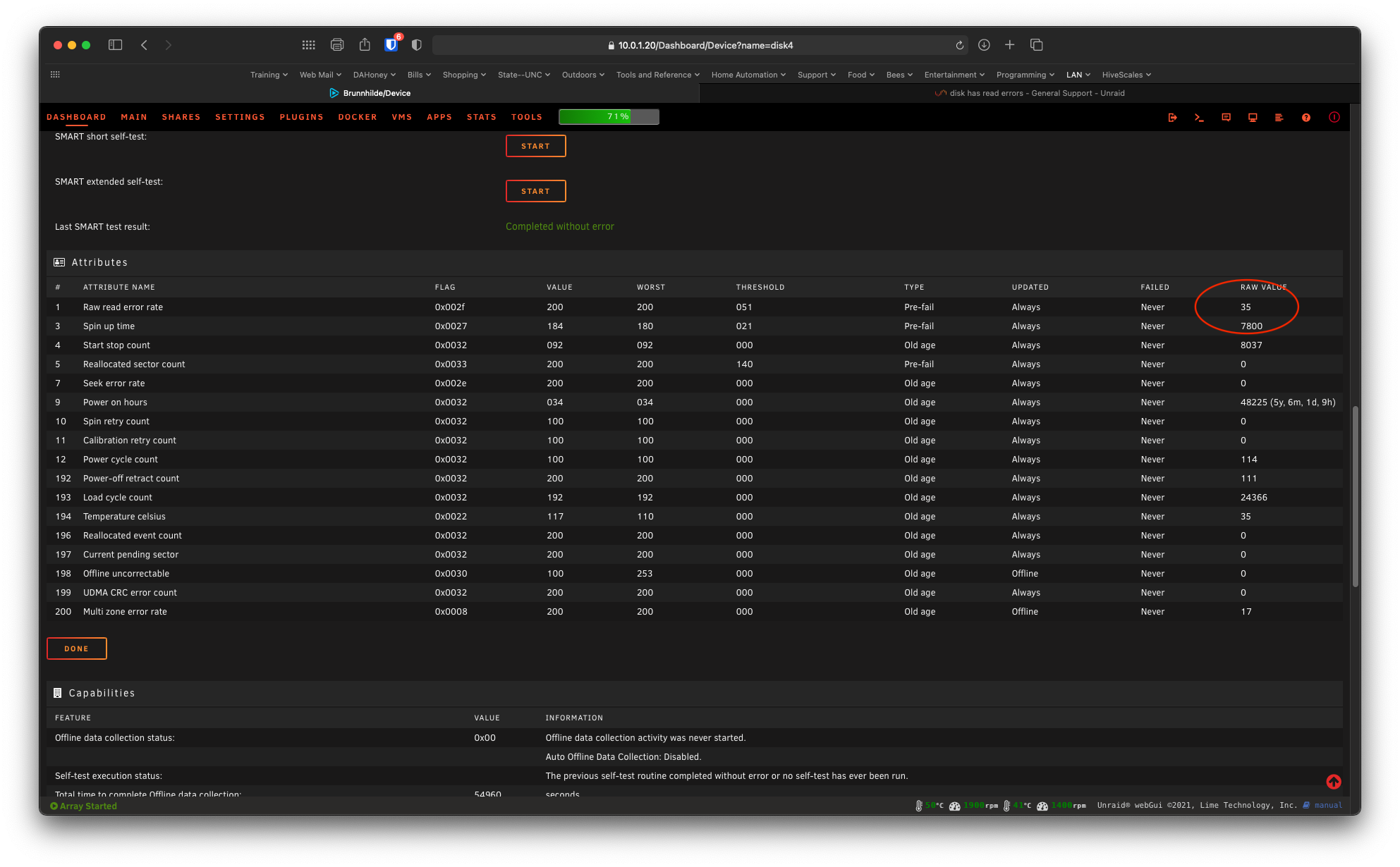

July 24, 20215 yr I recieved a warning that disk 4 has read errors. The disk is not disabled though. Still has a green dot. Not sure how to correct this? brunnhilde-diagnostics-20210724-0734.zip
July 24, 20215 yr Community Expert It's logged as a disk problem, but the sectors were successfully re-written, hence the disk remaining enable, good idea to run a SMART extended test, and if it passes monitor this attribute, you can add it to the SMART attributes monitored by Unraid for any WD disk, if it continues to increase there will likely be more errors soon: ID# ATTRIBUTE_NAME FLAGS VALUE WORST THRESH FAIL RAW_VALUE 1 Raw_Read_Error_Rate POSR-K 200 200 051 - 35

July 24, 20215 yr Author No warnings are showing on Dashboard. Disk 4 shows healthy. The only place I’m getting the warnings is in the daily status report email as far as I can tell. Is it possible that the Status page reset when I started the extended smart test?
