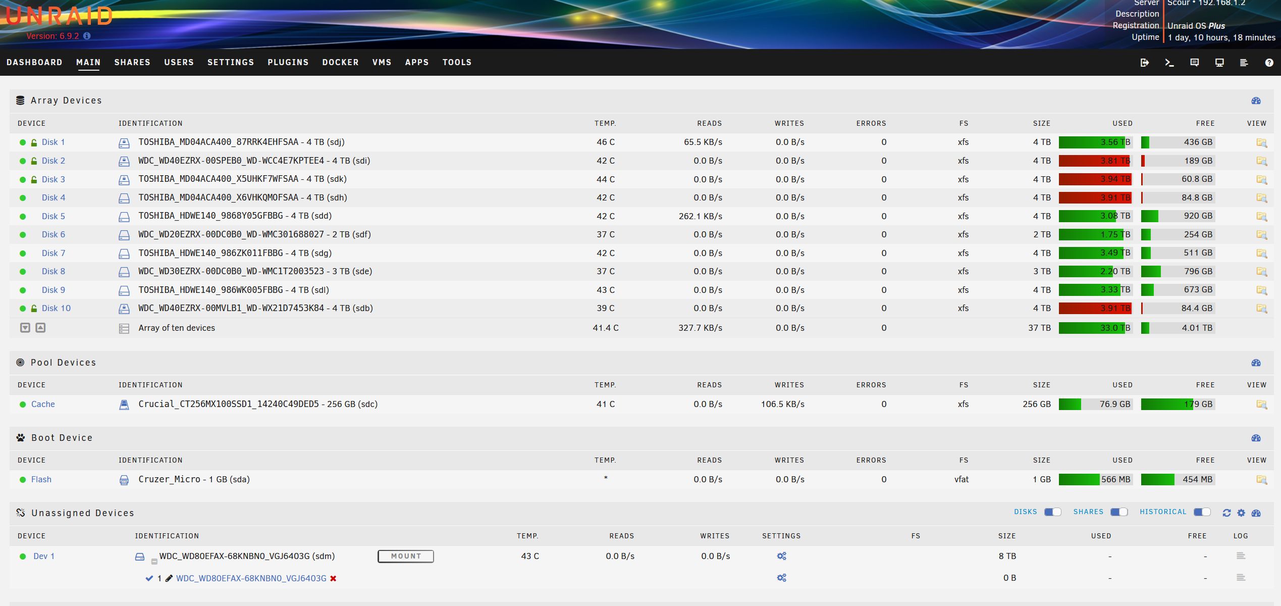

I'm  in the process of encrypting my array, following SpaceInvader One's guide, so I'm currently operating without parity to speed things up.  I received the popup notification "Offline uncorrectable is 1" for Disk 2, which I successfully encrypted and copied data to/from without errors yesterday.

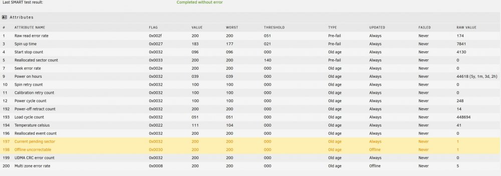

Today, while copying data with unBALANCE between two other disks I received the above error.  SMART shows 1 Current Pending Sector.

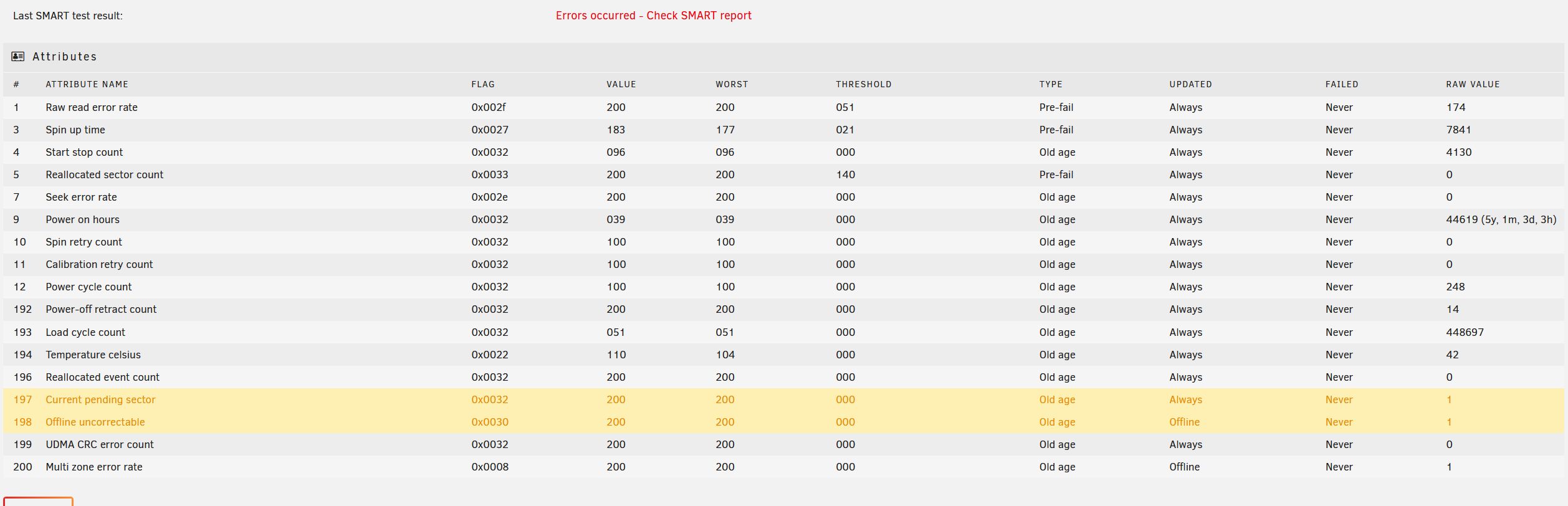

I then ran an extended SMART test (attached) and nothing appears to have changed.  On the Main WebGUI page, Disk 2 still has a green ball and shows no errors.  I realize the drive is getting old and I plan to replace it soon, however I just want to get through this encryption process successfully.
SMART test failed, so the disk should be replaced.
