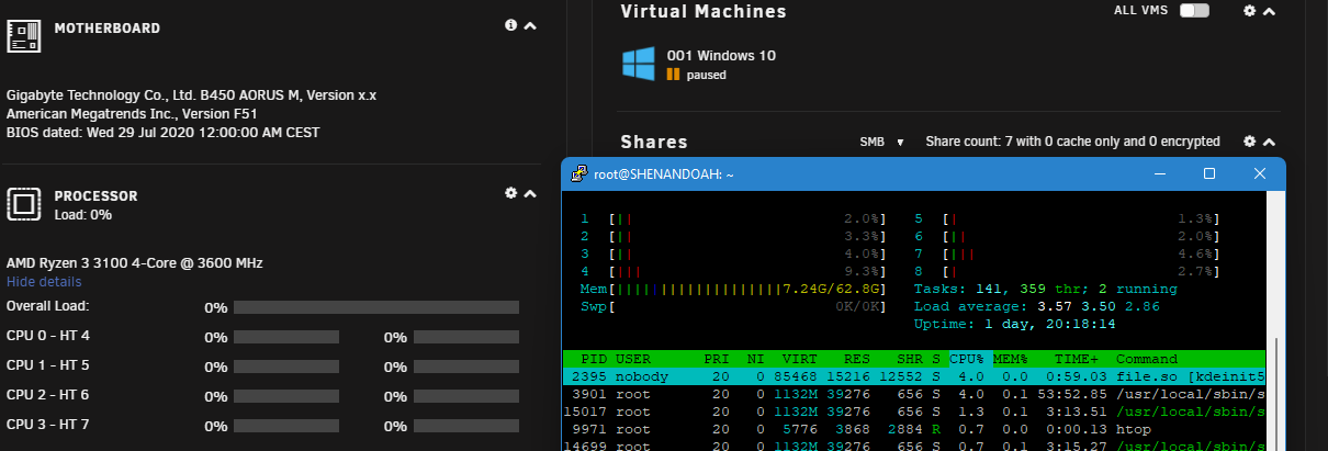

August 1, 20215 yr Hi! I have a fresh unRAID Installation with version 6.9.2. At my dashboard I can't see CPU load. Dashboard shows always 0%. If I start a putty session I can see the load. Is this a known topic or is there any solution for the problem? BR Jens

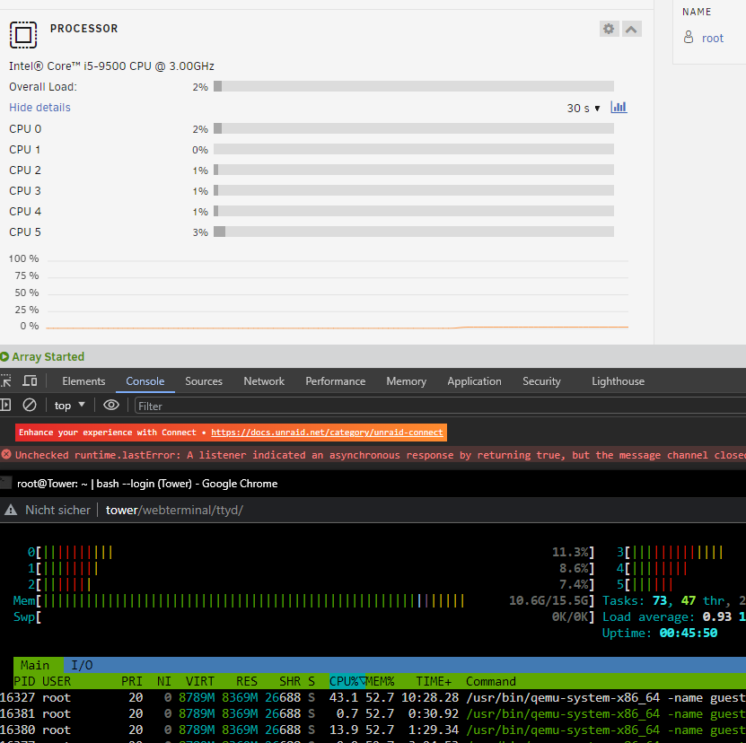

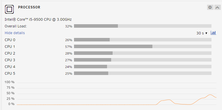

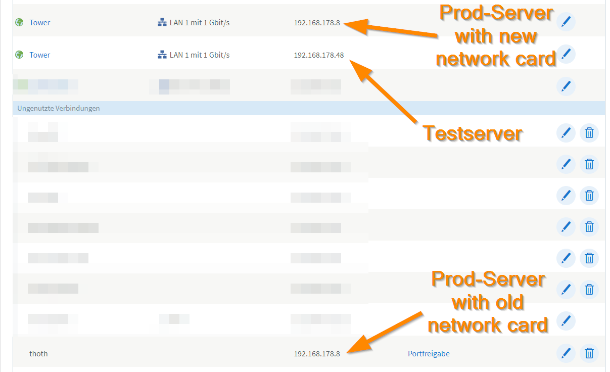

October 28, 20233 yr It seems I'm having the same problem on my test server with Unraid 6.12.4 Error message of Chrome Dev Tools: Quote Unchecked runtime.lastError: A listener indicated an asynchronous response by returning true, but the message channel closed before a response was received This server is relatively empty, so it does not have any Docker installed at all. But I think it could be because of my in my router (fritz.box). I had a similar issue in the past which got solved after disconnecting the server and deleting all network devices with the server name from my routers webgui network devices overview. At the moment some downloads are running. I will check this later and update my post. EDIT: And as I thought it was because of my fritz box. This router does crazy things if a mac address changes for a device, which has active port redirects. A similar issue causes the problems with MACVLAN and docker containers. My environment: - thoth, my productive server with the fixed ip .8 and active port redirects for the ports 80 and 443 - tower, my test server with an dynamic DHCP address, at the moment .48 A few days ago I changed the network card of "thoth". So it got a new mac address. This causes this mess: As you can see the productive server with the correct name is listed as an "offline device", but with active port redirects ("Portfreigabe"). In addition I got two "Tower" servers, which absolutelly does not make sense as my productive server never had this name. It is unchanged "thoth" since several years. How to solve this mess: - shutdown both servers - remove the port redirects of "thoth" - boot "thoth" - add the port redirects again Now I have my two network devices as expected: And my CPU dashboard works, too: But why does it solve the above problem? I think the reason is, that the Fritz Box randomly answers DNS requests for "tower.fritz.box" with the IP .8 or .48 as it knows about two different network devices with the same name. This bug (?) is present as long I can remind. But even if AVM solves this I'm still confused why my productive server sometimes is detected as "Tower". Does the server boot with this name and changes it after reading the config files from the USB drive?
