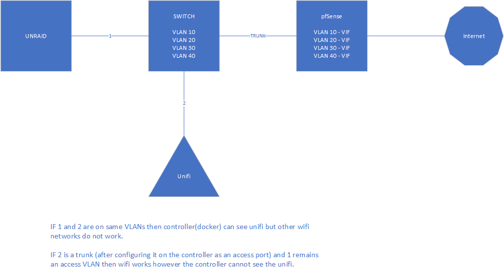

August 19, 20215 yr Author Here is a updated Visio diagram. I had the numbers backwards. Edited August 19, 20215 yr by BrunoVic Fourth time is a charm
August 19, 20215 yr In my opinion, it is not network problem. It is Unraid / docker not support multiple subnet/VLAN access, this should be know issue. May be someone have solution, may be add multiple docker for same service for different subnet/VLAN or make a reverse proxy between Unraid and the switch. But I haven't those experiences.
August 19, 20215 yr Author So if you see the diagram and explanation hopefully you can understand my predicament. My goal was to make 1 and 2 both trunk interfaces so that the AP might see the controllers if the controllers docker interface was configured with a VLAN id on the host (UNRAID). However when I configure VLAN ids on the host (UNRAID) it expects the main interface to still have an IP address otherwise it assigns an APIPA (169 address) and the docker bridge wants to use that 169 address instead of a specific VLAN.

August 19, 20215 yr 10 minutes ago, BrunoVic said: So if you see the diagram and explanation hopefully you can understand my predicament. My goal was to make 1 and 2 both trunk interfaces so that the AP might see the controllers if the controllers docker interface was configured with a VLAN id on the host (UNRAID). However when I configure VLAN ids on the host (UNRAID) it expects the main interface to still have an IP address otherwise it assigns an APIPA (169 address) and the docker bridge wants to use that 169 address instead of a specific VLAN. OK, which VALN ID is main / management ? And Unraud in which VlLAN ? Clearly, switch to Unifi AP must be trunk.

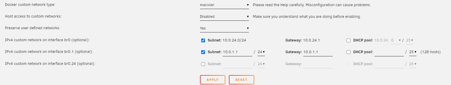

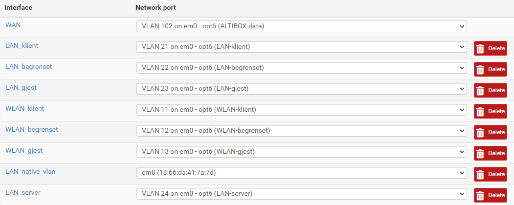

August 15, 20233 yr I think I have the same issue, kind of. I have been using UNRAID as a client (vlan not enabled) on VLAN 24 (configured on cisco switch). I also have a pfSense Router where untagged traffic is the management network and all other networks has vlans. pfSense My cisco is very default, 1 is default vlan I try to install the UniFi Controller, so I first enabled vlan on UnRAID with vlan 24 as the first one. Looks like this is "native" for the UnRAID now? And it works, I can manage man unraid server with 10.0.24.10, an all my containers has 10.0.24.10:port. So I tested adding a vlan "vlan1" that should how I understand it be the same as untagged. But how it looks, it is on br0.1 i don't know if this means it's tagged or if it is just a name for the virtual vlan nic(??) The unifi-controller is set to use Custom : br0.1 -- LAN_native_vlan, and it is as shown in the picture assigned (automatic?) 10.0.1.2. But that address is not leased by pfSense, did UnRAID lease it from itself? It is not accessible. I think it might be two different vlan 1's here?
