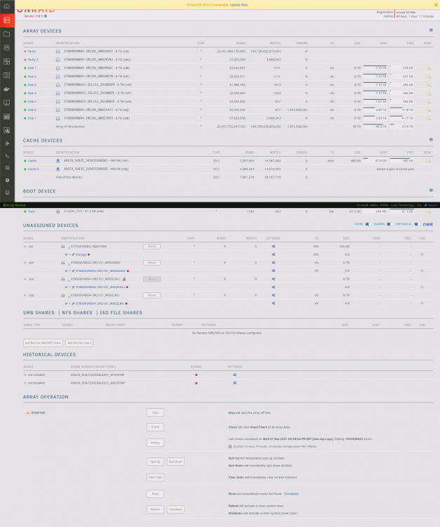

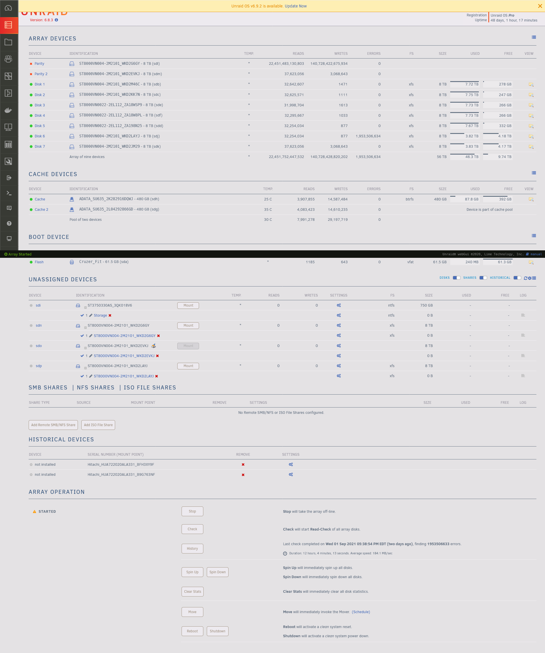

Post a screenshot of Main - Array Devices
The screenshots show some of your array disks disconnected and reconnected as different devices, and that is why they show up in Unassigned.
The screenshot doesn't agree with the Diagnostics you posted earlier though. Post new diagnostics.

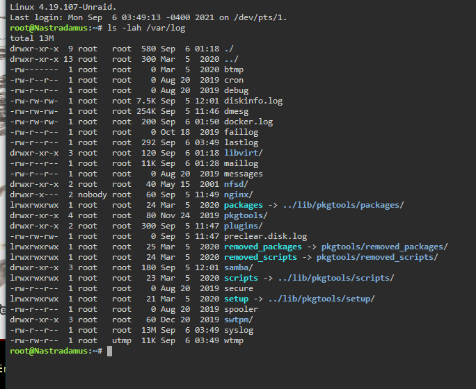

Your log space was full before reboot, and shortly after reboot your log space is nearly 10% full even though syslog isn't very large. I don't quite remember exactly what shows up in diagnostics for your old version of Unraid, but there also doesn't seem to be any logs from docker or vm. You have those enabled but do you actually have any dockers or VMs?
My usual suspect for filling log would be atop from NerdPack, but you don't seem to have that either.
What do you get from command line with this?
du -h -d 1 /var/log

What do you get from the command line with this?
ls -lah /var/log
ls -lah /var/log
