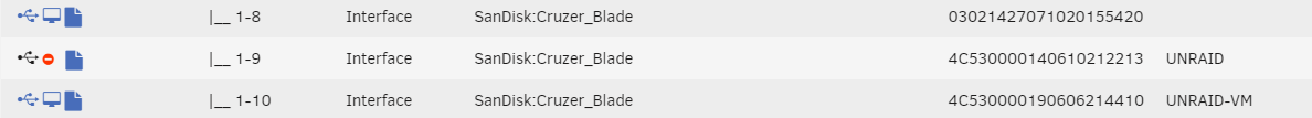

root@computenode:~# lsusb
Bus 004 Device 001: ID 1d6b:0003 Linux Foundation 3.0 root hub
Bus 003 Device 001: ID 1d6b:0002 Linux Foundation 2.0 root hub
Bus 002 Device 002: ID 1c04:0015 QNAP System Inc. QNAP QNA-UC5G1T USB to 5GbE Adapter
Bus 002 Device 001: ID 1d6b:0003 Linux Foundation 3.0 root hub
Bus 001 Device 006: ID 0781:5567 SanDisk Corp. Cruzer Blade
Bus 001 Device 004: ID 0781:5567 SanDisk Corp. Cruzer Blade
Bus 001 Device 005: ID 1c4f:0016 SiGma Micro USB Keyboard
Bus 001 Device 003: ID 05e3:0606 Genesys Logic, Inc. USB 2.0 Hub / D-Link DUB-H4 USB 2.0 Hub
Bus 001 Device 008: ID 05e3:0608 Genesys Logic, Inc. Hub
Bus 001 Device 007: ID 0781:5567 SanDisk Corp. Cruzer Blade
Bus 001 Device 002: ID 048d:04d2 Integrated Technology Express, Inc. UDisk
Bus 001 Device 001: ID 1d6b:0002 Linux Foundation 2.0 root hub
root@computenode:~# lsusb -vs 001:007 | grep 4C530000190606214410
  iSerial                 3 4C530000190606214410
Bus 001 Device 009: ID 0781:5567 SanDisk Corp. Cruzer Blade
root@computenode:~# lsusb -vs 001:009 | grep 4C530000190606214410
root@computenode:~#

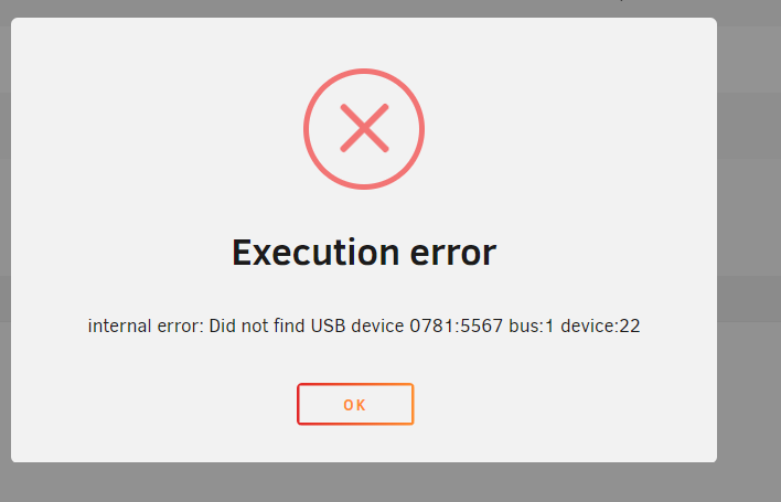

On 9/3/2021 at 5:34 PM, ghost82 said:
so if we have two devices with same product/vendor id, let's say both at bus 2, device 3 and 4, I would try this to have them in the same guest both at bus 1, port 2 and 3:
I can confirm this works, but if I unplug the device it will change the Device number and the VM wont find the device. Also after a reboot device may be renumbered.
 <hostdev mode='subsystem' type='usb' managed='no'>
      <source>
        <vendor id='0x0781'/>
        <product id='0x5567'/>
        <address bus='1' device='22'/>
      </source>
      <alias name='hostdev0'/>
      <address type='usb' bus='0' port='2'/>
    </hostdev>
      <source>
        <address bus='1' device='21'/>
      </source>
