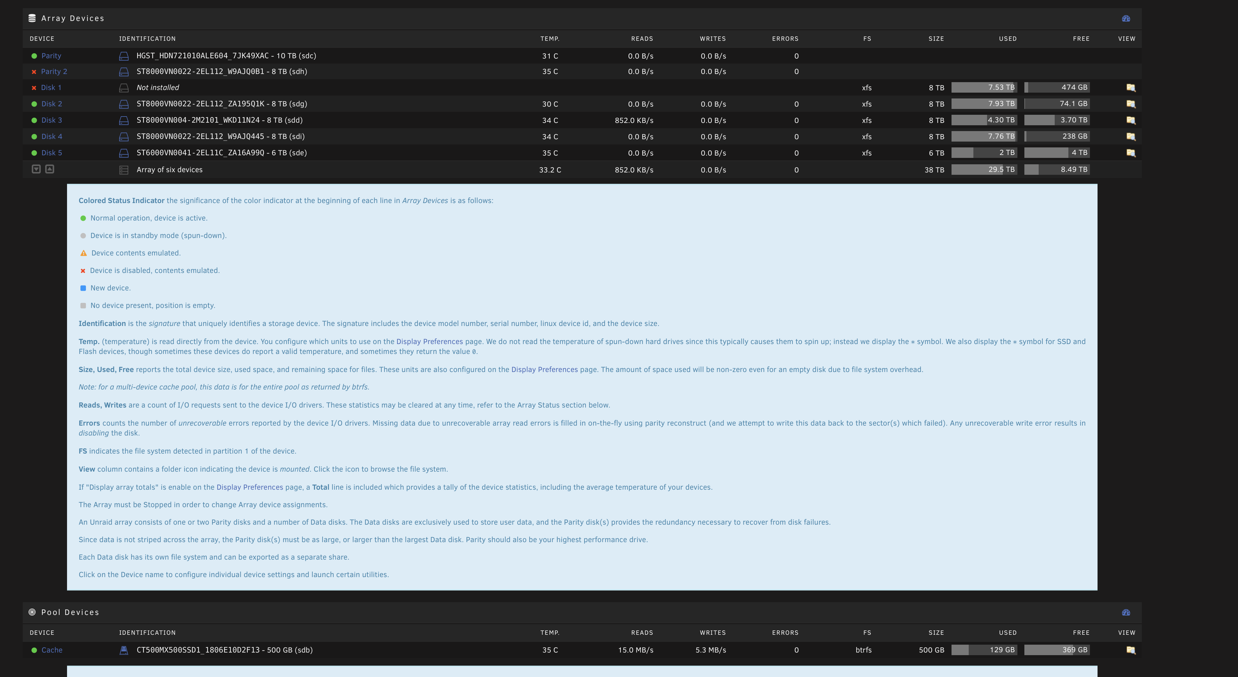

New diag after check the cable and reboot
seems nothing changed 😅

There was a change - disk1 now shows up in the SMART information and shows no obvious problem so the drive may actually be fine.
Do the contents of the emulated disk1 look OK?  Asking because what shows on the emulated disk is what you end up with after a rebuild.
Do you have a spare disk you can rebuild to (safest).  If so rebuild to that keeping the old disk1 intact until the rebuild completes successfully (and you can then test its health).  If not you can try rebuilding to the old disk1.  The processes for both cases are covered here in the online documentation that can be accessed via the Manual link at the bottom of the Unraid GUI.
