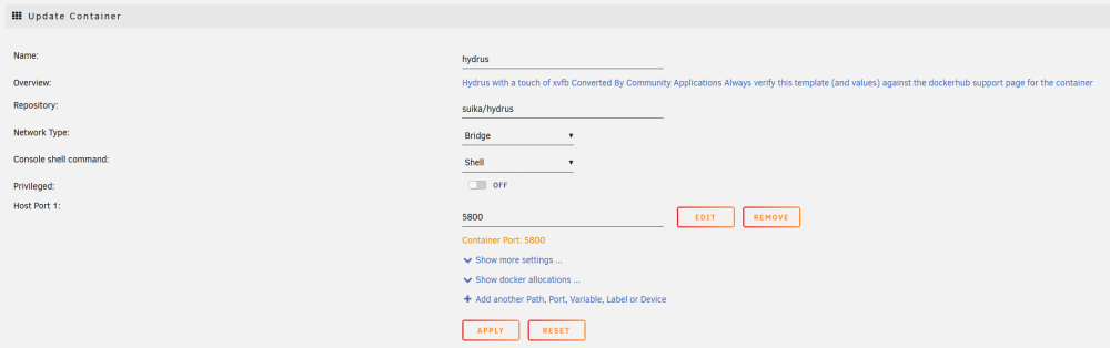

I couldn't find anything in Edit settings that shows where its files are located.
Doesn't look like you configured any path mappings so the container only has access to internal storage (inside docker.img).

I'll happily delete the application and reinstall it since I've not done any configuration, but when I look at installing it, I don't see how to redirect where it installs to. Adding the host paths just adds access to the shares from what I've seen.
The docker page for that container explicitly states to add another mapping for persistence
For persisten storage you can either create a named volume or mount a new/existing db path -v /hydrus/client/db:/opt/hydrus/db.
