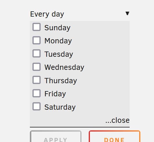

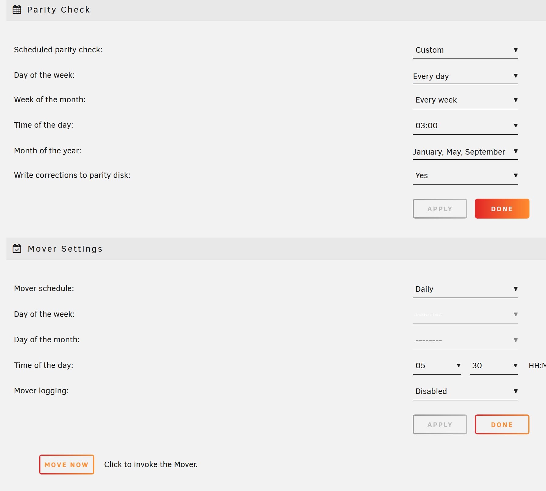

Had to wait for current check to end before accessing the scheduler.. it seems I can only click it form the main page, but the link is not there while it is running.

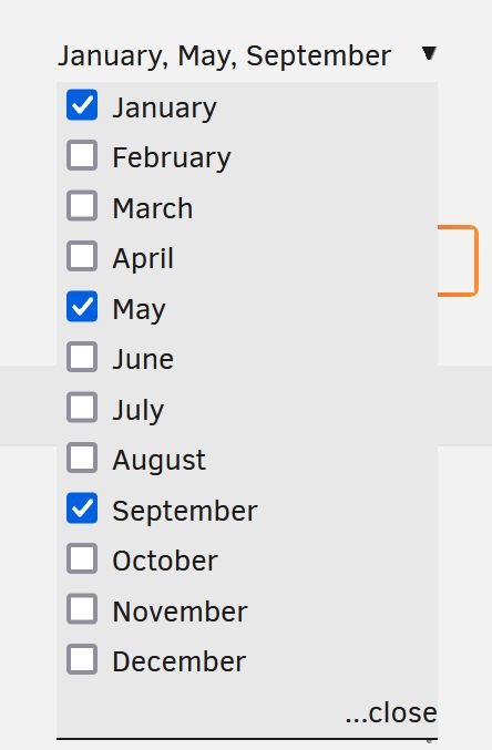

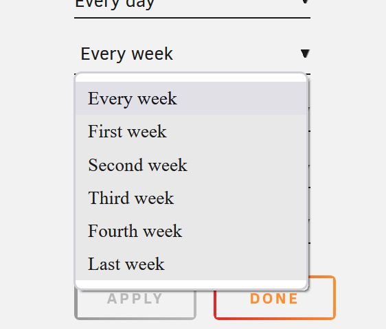

I have it set to MONTHLY at 3:00am... with 3 months between checks. It still says "daily" and "weekly"... if I click on daily nothing it ticked, if I click on weekly there are no tick boxes... and if I click on monthly you can see the ticks...

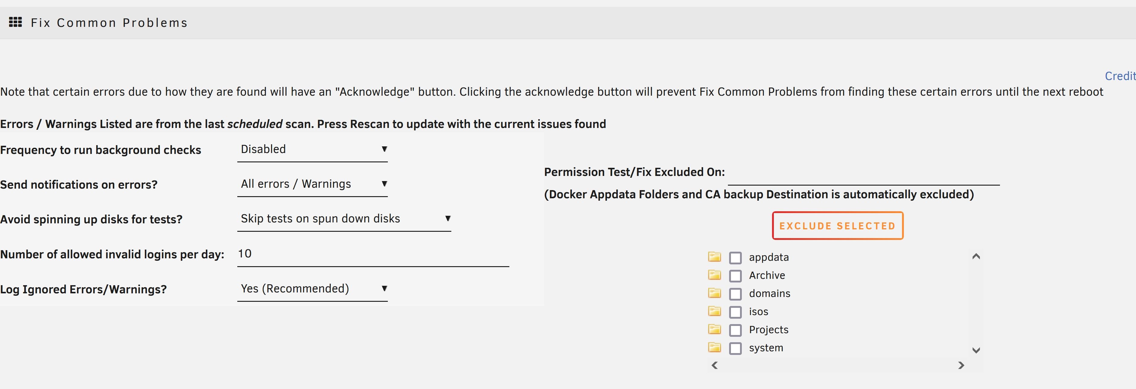

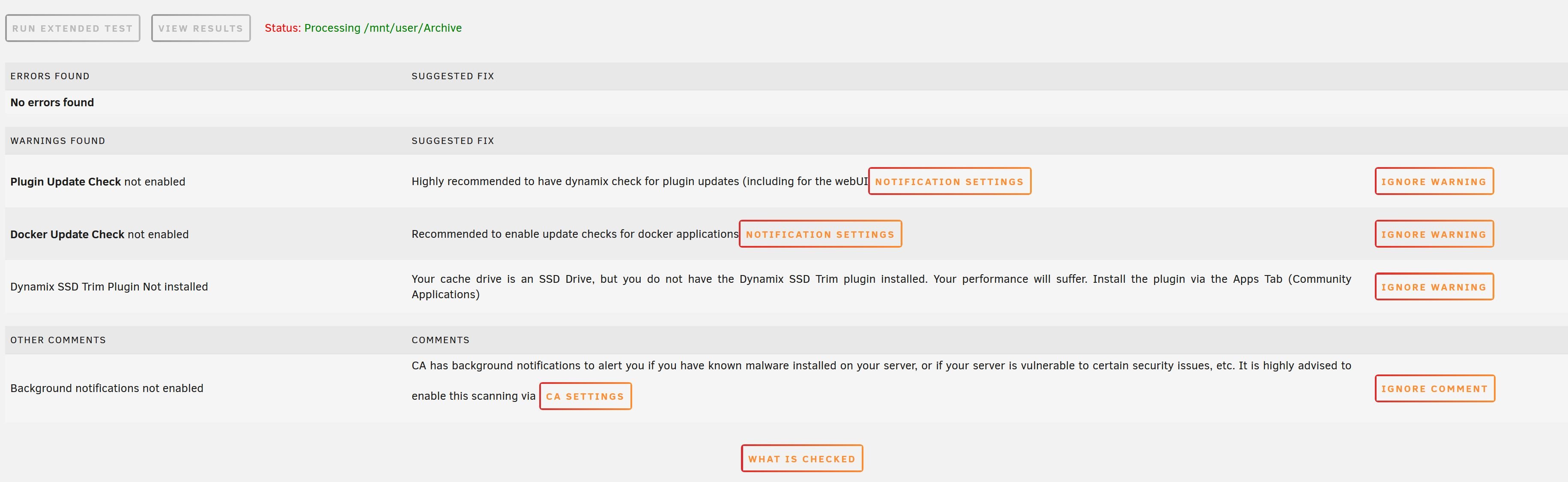

I also installed a plugin I read about called "fix common problems".... the "full scan" is still in progress...
Never tried anything other than a monthly parity check on a fixed date, so I can be mistaking.
Your setting look a lot like Parity check runs :
  • every day
  • of every week
  • for January, May and September
And since we are in September ...
Maybe try to pick a day and a week ?

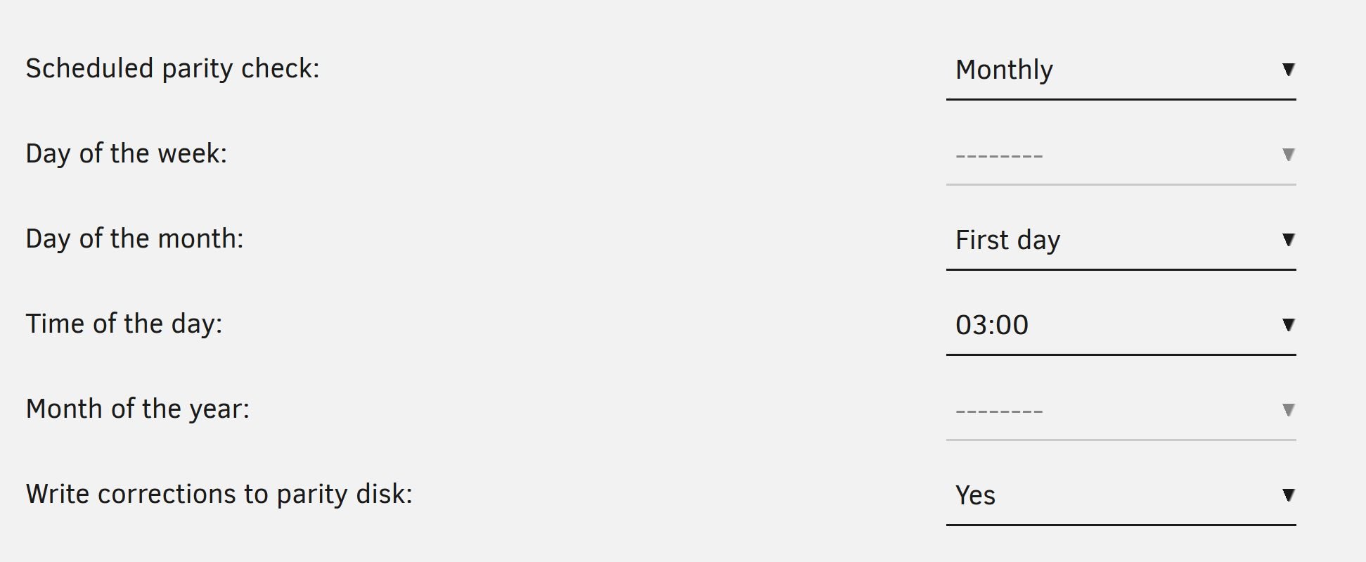

Changed it from "custom" to monthly, like you suggested.
It is normally recommended that the option to Write Corrections as part of a scheduled test set to No.   the rationale is that if you have a disk that is playing up and you have not realised it you do not want to allow it to corrupt parity thus potentially prejudicing good recovery of any other disk that might have problems.   I always suggest to not write corrections to parity until you have rectified (and hopefully fixed) whatever caused the problem in the first place.
ok.. I changed it to being off like you said... dose this mean I need to scan now and then with it turned on? Like what exactly does this option mean?
It means scheduled parity checks will be correcting checks. Not recommended for reasons already given.
