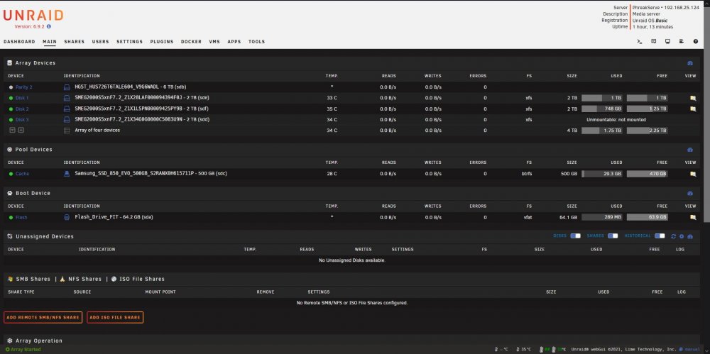

You have 3 connected 2TB disks, all 3 are assigned to the array, don't understand what exactly is the problem.
Disk 3 = Unmountable: not mounted

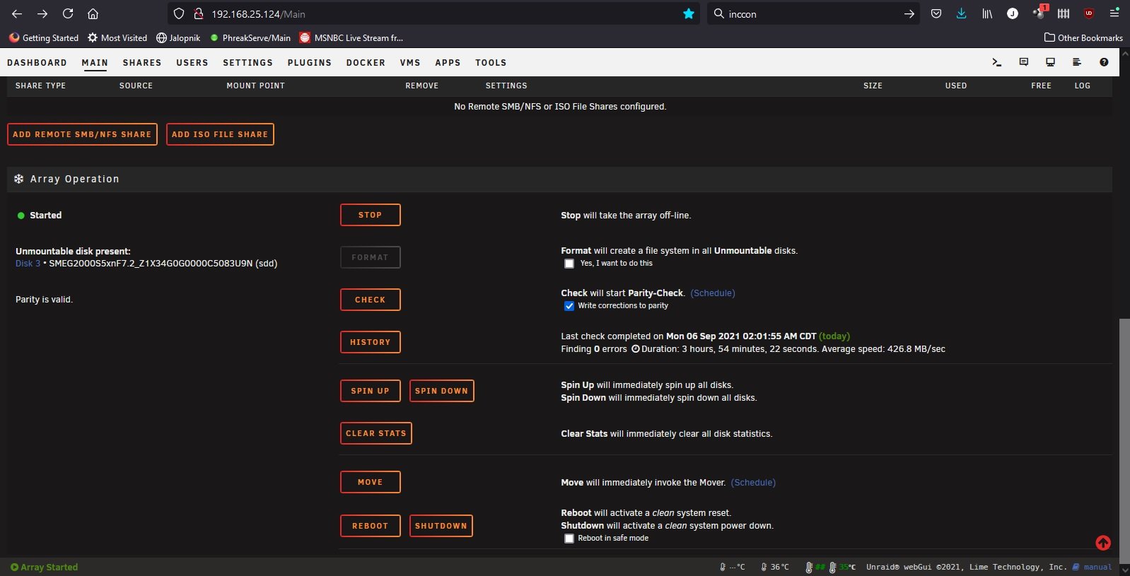

Post a screenshot of Main - Array Operation
bump
7 hours ago, Phreaknes said:
Tick the box saying Yes I want to do this and hit the Format button.
