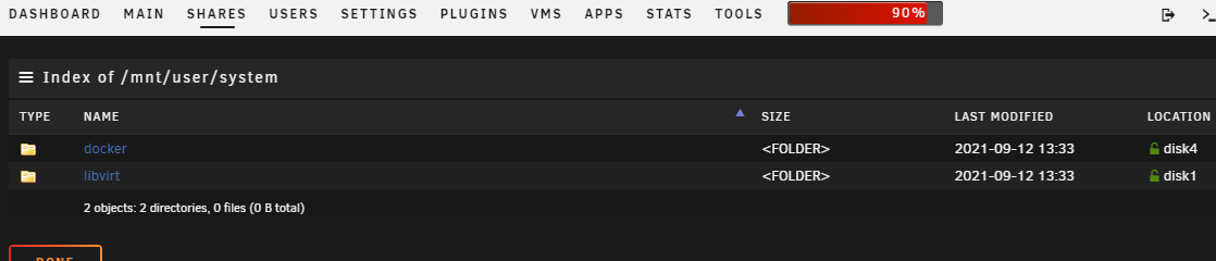

Before I do, docker has created some files on the system share. Should I delete these before attempting the repair? The files will also be in the cache as system share is set to 'Prefer : Cache'

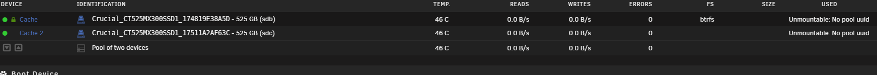

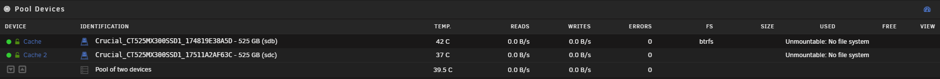

I've stated the array, and fomatted the "unmountable" drives, which are the 2 cache drives.
After the format completes, I get this error:
"Unmountable: no pool uuid"
I've removed both drives from the pool, and set slots to zero to delete the pool, then created a pool of 2 and re-added them, but the error persists.
I can't mount the drives.

Solved the issue. I stopped the array, set all shares to 'Use Cache Pool? No', deleted the docker image in settings-docker, deleted the virtlib file by stopping VM and chosing delete from "Settings - VM Manager".
Disabled the syslog server in settings, then deleted the syslog server files from the cache using MC.
Then rebooted the server, added a cache pool, added the drives, stated the array, formatted the drives.
I'm now copying the data back to the cache.

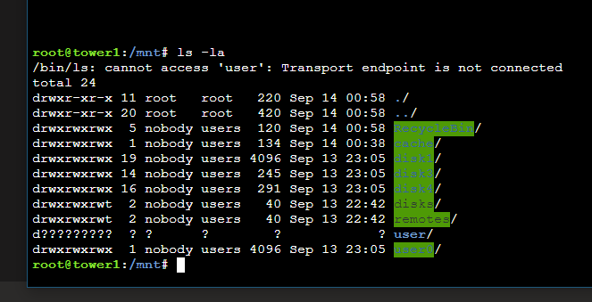

Installed the 1st container from the APPS -> previous Docker tag. The install failed with an error saying couldn't create /mnt/user/ and then all my shares disappeared!
Any idea how to fix that? The 'user' share seems to be broken.
Sep 14 01:00:01 tower1 kernel: shfs[25263]: segfault at 0 ip 00000000004043b8 sp 0000146026a3d780 error 4 in shfs[402000+b000]
shfs segfaulted, rebooting should bring your shares back, but if it continues to happen it might indicate an underlying issue.
Thanks. That's worked and a docker container started ok.
