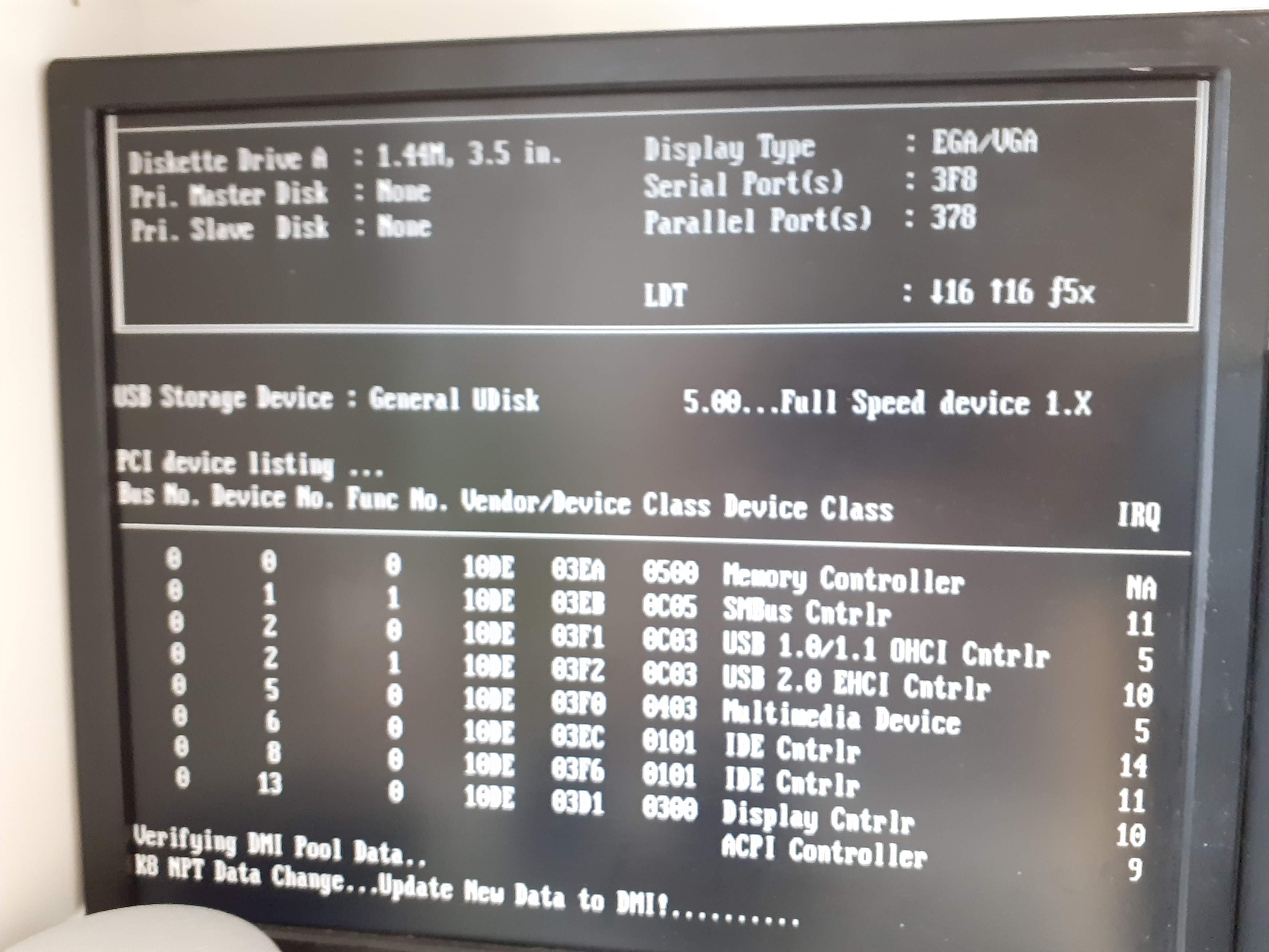

I have recently acquired an older machine that I am trying to boot unraid on.
I'm currently only getting to the following screen: (Attached image)

Give us the name and model of the Motherboard that you are using.  The CPU info might help also.  How much memory is installed on the MB?
The reason for this question is that this seems to indicate that the USB port is going to be booting up in USB1 which will take forever.
(I had an old AMD board when I built my first Unraid server and the USB port booted in USB1 and it took minutes for the OS to load in those when the Unraid footprint was much, much smaller!)
Interesting the motherboard is a gforce 6100SM v :1
The cpu is AMD Athlon 64 X2 4850e ADH4850IAA5DO Dual-Core 2.5GHz Socket AM2 Processor CPU
8gb ram in two sticks. Trying it in other ports doesn't seem to change anything. Maybe it does only have usb 1
I've left it for over an hour with the screen not changing from my screen shot. I feel like it should get to the grub screen.
Google and see if you can find a manual if you don't have it.  I suspect that you will have to go into the BIOS and set it up to boot off a USB device.  This could be found in a either the hard disk, or a list of removable devices, or under the Floppy disk options.  (At one time,--back in the era when this MB was new --- LimeTech had a generic discussion about getting USB drives to boot on various MB's as it was a new thing at the time!  But I can't seem to find that any more.  You do realize that the MB has limited options as far as modern usage as it only has two SATA ports.  You might want to look for MB that is five to eight years newer...)
