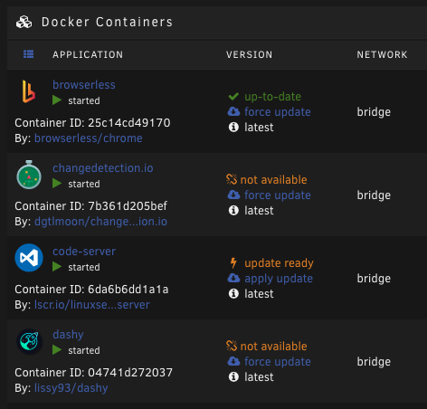

September 23, 20215 yr When I try to Check For Updates on the Docker page, each docker just spins forever. I see this error in the syslog Sep 23 15:43:25 Tower nginx: 2021/09/23 15:43:25 [error] 8444#8444: *269827 upstream timed out (110: Connection timed out) while reading response header from upstream, client: 10.11.79.248, server: , request: "POST /plugins/dynamix.docker.manager/include/DockerUpdate.php HTTP/1.1", upstream: "fastcgi://unix:/var/run/php5-fpm.sock", host: "10.11.79.162", referrer: "http://10.11.79.162/Docker" Any ideas?
September 29, 20215 yr Author @Squid new issue that may be related. When I go to the Plugins page, the status for each plugin says Unknown. I click on the Plugins header at the top and it will come back after only 10 - 20 seconds and say unknown for status. I have to do this 5 or 6 times and then it will take about 2 or 3 minutes to come back and then say Up to Date. I've never had this issue before. Now looking at my Docker page, it now says up-to-date. However, if I click on the Check for Updates at the bottom, each one just spins, same as before and I get the error in the syslog. The docker page never recovers, will spin forever until I go to another page, Main for example. When I go back to the Docker page, it will say up-to-date. So the check seems to work (maybe), but given the syslog errors and the fact that the docker page never refreshes, something is still wrong. I've tried changing to another ISP DNS, but that didn't help. Any ideas? tower-diagnostics-20210929-0542.zip

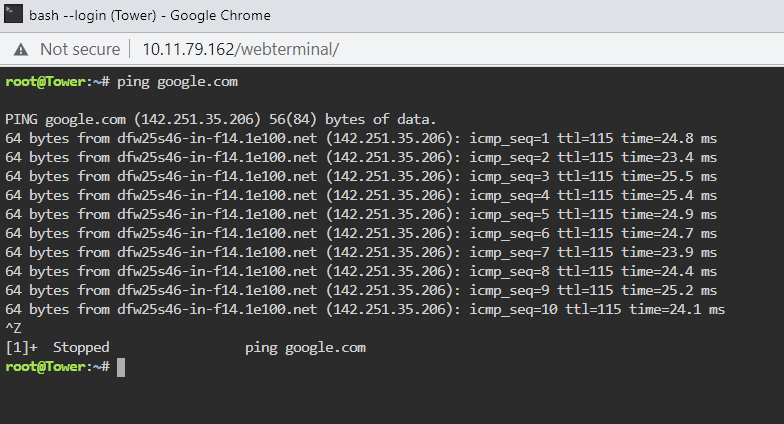

October 2, 20215 yr Can you ping google? ping google.com Try different DNS addresses (I suggest 208.67.222.222 & 208.67.220.220)
October 2, 20215 yr Author That did it! Thank you! Thank you! Thank you! I haven't changed the dns servers in a long time, so I have no idea why they stopped working, but plugins page loads and docker check for updates works fine now ping after the change,

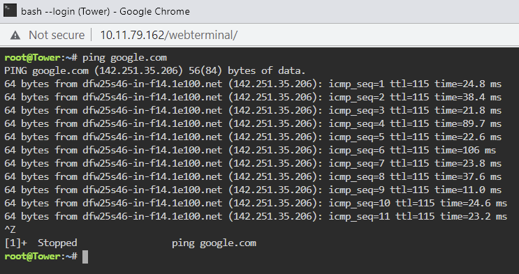

January 22, 20233 yr Having the same problem. I've changed DNS Servers and got the same issue. Any ideas? tower-diagnostics-20230121-2302.zip Edited January 22, 20233 yr by rainmanjam
January 27, 20233 yr Have the same issue. “i” did not solved, different DNS addresses 208.67.222.222 & 208.67.220.220 solves for 2-3 days.
