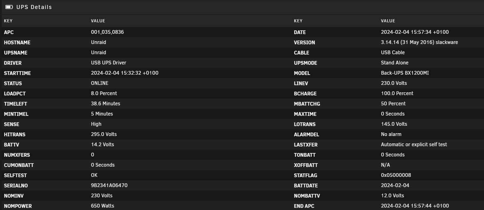

  1. i just bought a new BX1200MI, and has the same issues. As I have tested, battery fail reports only if usb attached to Unraid, attached to a Win laptop, through Powerchute, I cannot reproduce the error, neither self test fail. I have tried too the apctest, but self test fails, calibration fails, but through Powerchute, succeeds, without issue. Seems like a communication issue with this serie of ups with Unraid??? (have the same outcome with NUT too) I am running out of ideas, because ups works fine, not sure if it should be returned or just ignore the errors it gives to Unraid. **Update** I have connected the UPS to Powerchute and disabled the warning for battery, then connected back, I am still getting the errors
  2. All my issues solved with update to 6.12 RC, so I assume it's not my setup. My server is back to normal.
