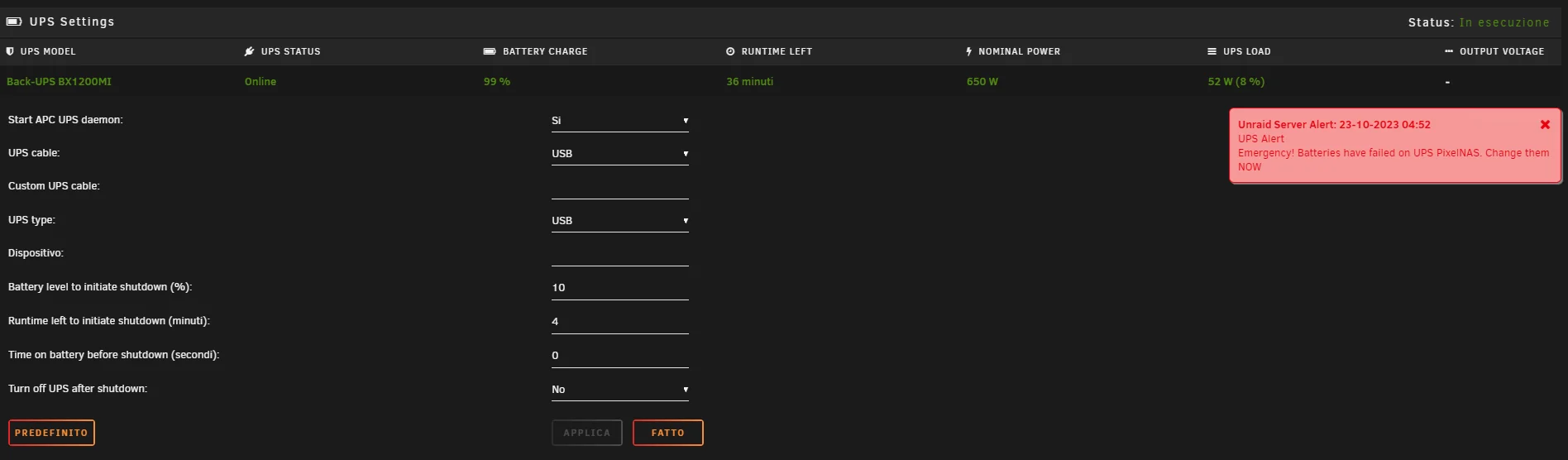

Hi everyone, I bought this new UPS from Amazon 3 days ago: APC Back-UPS BX1200MI.
I turned it on and unraid immediately recognized it, the problem is that occasionally, I get the notification of battery problems, but I don't see any errors.
I tried to run the UPS self test and it didn't give any errors.
I tried connecting it to a Windows PC and running the test from its proprietary software and it didn't give any errors.
I tried turning off the power and it worked fine for the first 4 minutes, then in unraid it alarmed again and made unraid shut down.
I then tried to turn off the power and connecting the USB to the Windows PC to monitor with the proprietary software and it didn't give any type of error for more than 20 minutes. When it reached around 50% battery I turned the power back on.
Anyone have any ideas? Could it be due to the date of the batteries which is reported as 2001-01-01? If the product is new and never used, is this a problem? Can I simulate a battery replacement today by telling the UPS that I changed them to see if the error was caused only by the old date? Can it be done from unraid or do I have to use its software?
I add that the battery always remains at 99% after 3 days and does not reach 100% so I cannot do the calibration from apctest.
Thanks

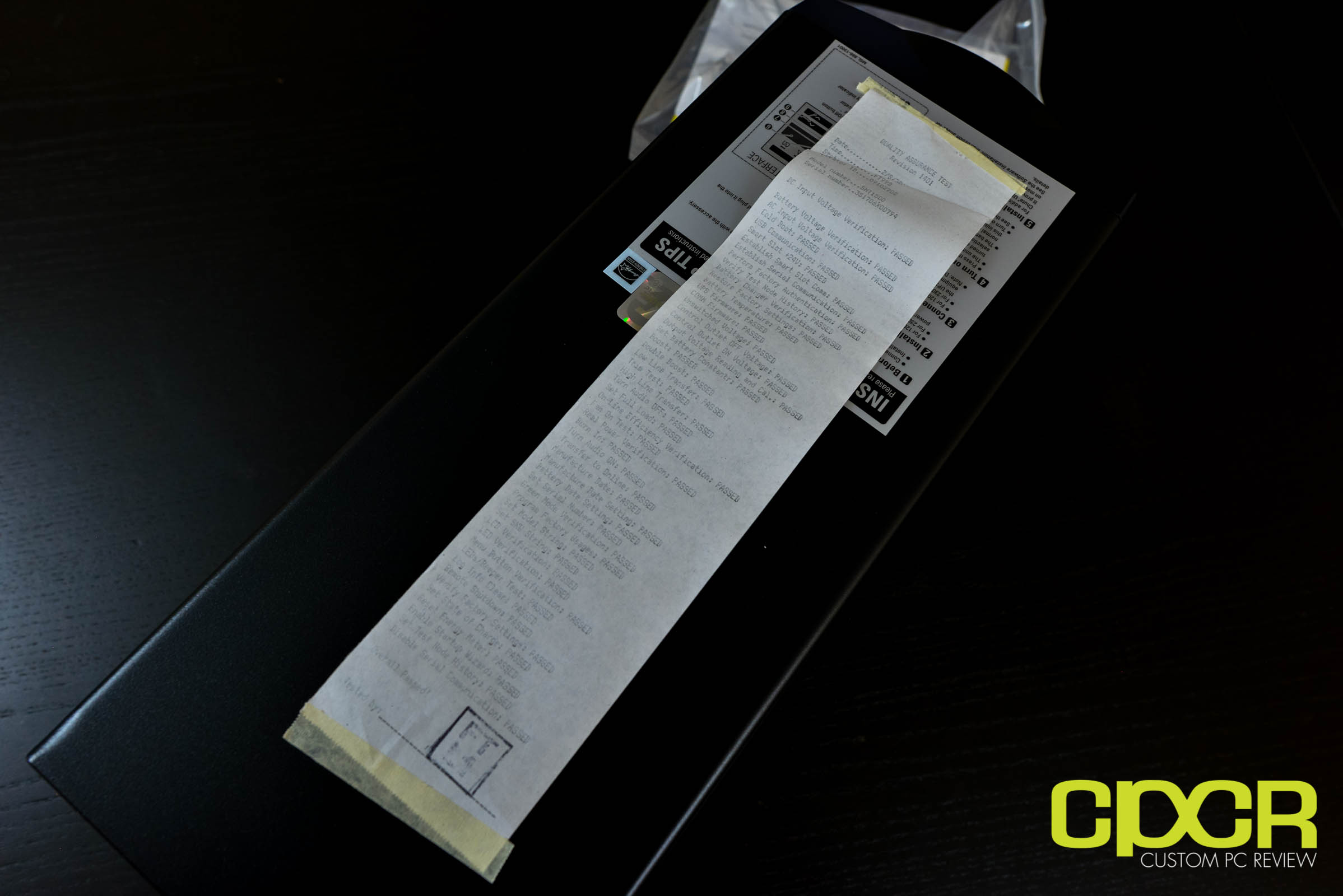

Not relate. You should got a mfg test report in package, check the mfg date.

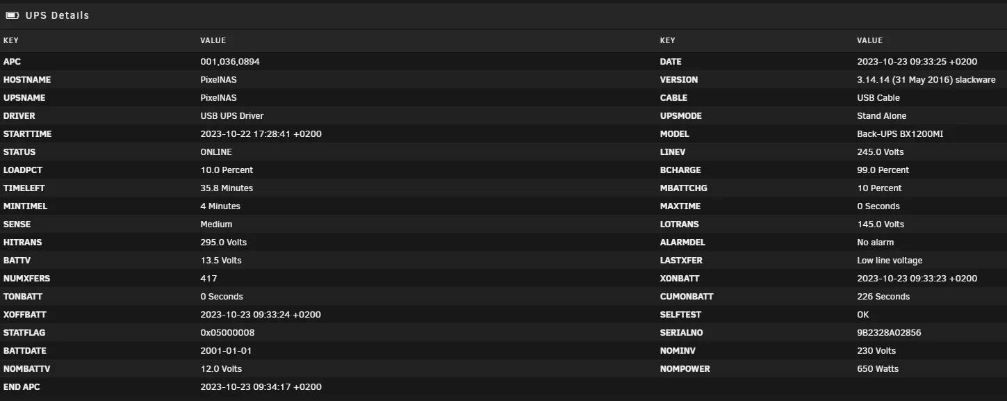

Your problem likely because "low line voltage" and have 417 times transfer to battery. This also may be the reason why battery does not reach 100%.

I didn't understand the thing about the mfg test report in package, where can I find it?
Now the low line voltage is at 23
A paper slip inside the package.
23 ?
LOTRANS was 145v, so if line voltage below that, it will switch to battery.
23 ?
I don't have any sheet with tests performed on the UPS, perhaps they aren't performed in Italy, or they aren't included on Amazon.
The 23 referred to the value of NUMXFERS. I tried setting the sensitivity to low, to see if it switches to battery less often.

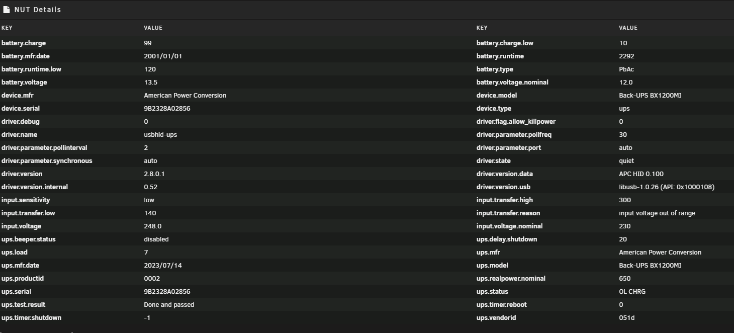

Base on that, it doesn't like UPS nor battery have problem, suggest turn off APCUPSD and install NUT for troubleshoot why APCUPSD will interpret the battery were fault and shutdown immediate. ( NUT can setting don't shutdown, so you can further troubleshoot ** pls stop array for safe ** )
After you disable all UPS monitoring, you can in command prompt type APCTEST to set battery date or perform selftest.
And you need fix why NUMXFERS so often !!!  ( Of cause, it may UPS fault )
Edited by Vr2Io
Hi, a little update, I switched to NUT as suggested, the problem was partially solved, now doing some tests, I stopped the array, turned off the power and the UPS kept the system on for over 30 minutes, once reached 25% battery, it turned off as scheduled.

However, I discovered why NUMXFERS is so high, the voltage in my house should be 220 volts, but often it is 240-245 volts, this unfortunately causes the UPS to regulate the voltage which I think is the reason why it doesn't reach never 100%. I'll try keeping the UPS on charge with nothing connected, to see if it gets to 100%.
