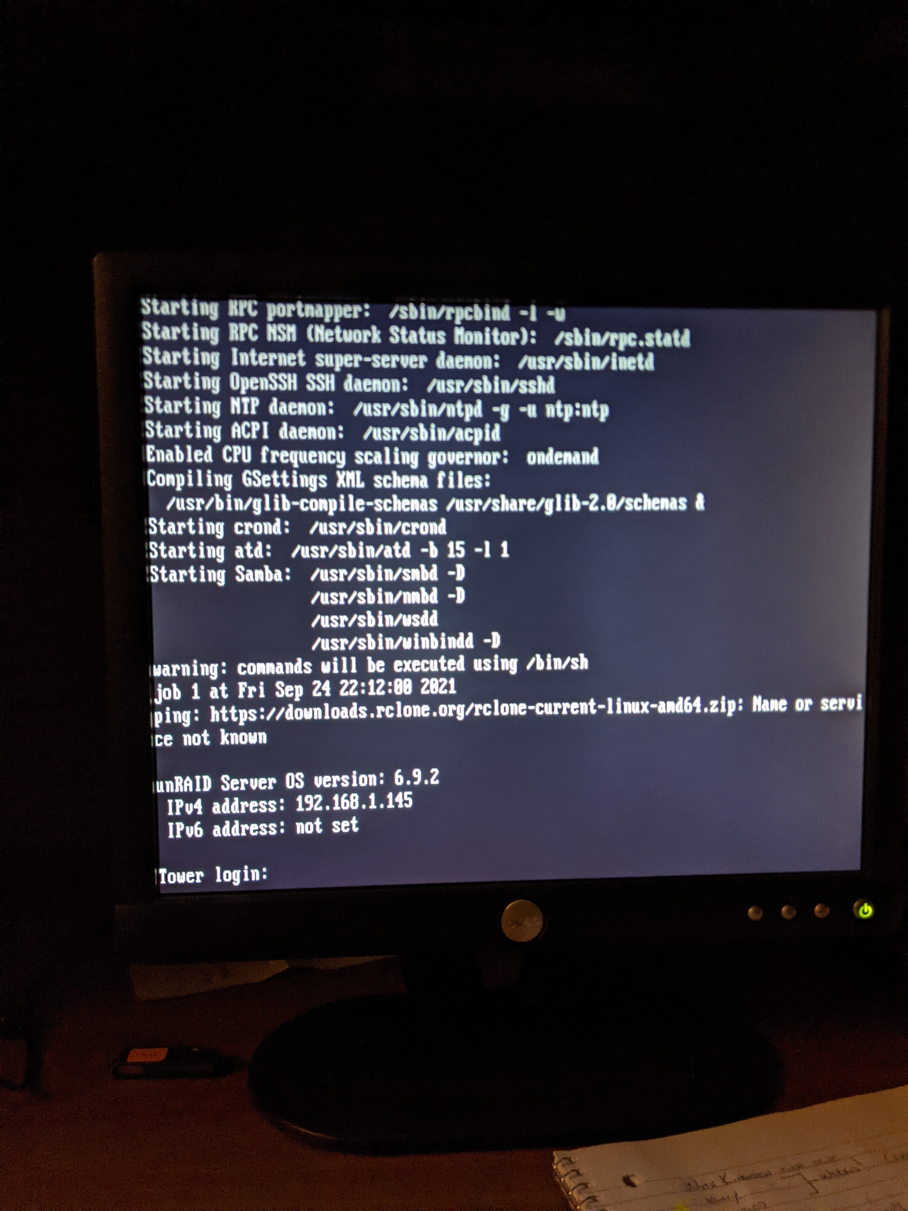

September 24, 20215 yr Community Expert Here is a list of the files on the Flash Drive: https://wiki.unraid.net/Files_on_v6_boot_drive One file you might want to use from the download version of the current operating system is the go file. One more recommendation is connect a monitor to the MB and watch the boot process. If it hangs during the boot process, take a photograph of it. Make sure that the text is easily readable and then post that photo up in a new post.
September 25, 20215 yr Author Thanks for the recommendations. I have a monitor hooked up and have been watching the boot process. It seems to boot up just fine, but I can't get to the GUI and I can't get to the shares/mapped drives from windows on a different computer. I've attached the last screen image. I can log in on this screen. I took a couple of more shots I can attach if they would help.
