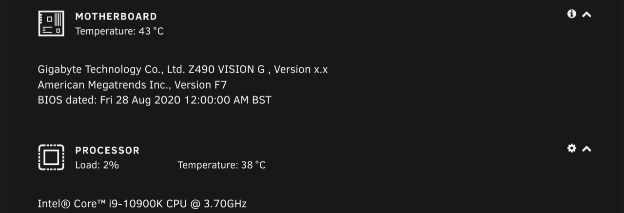

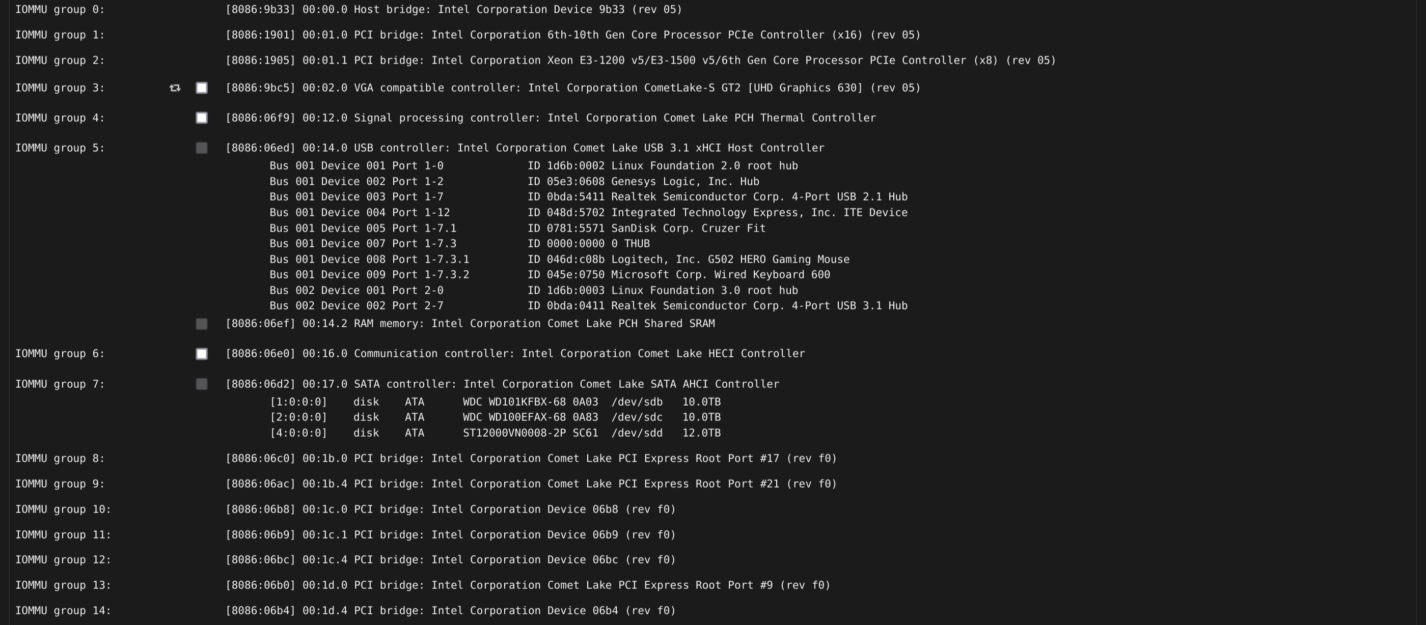

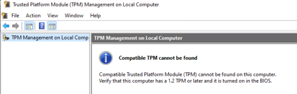

September 24, 20215 yr Hello, I have a Windows 11 VM running on my unRaid server however with the latest updates from Microsoft, they are starting to enforce the TPM requirement. I run a Gigabyte Z490 motherboard and have enabled via the bios the "Intel Platform Trust Technology (IPTT)", however the VM is still not detecting any TPM. I have read on the forums that I can either pass through the TPM or emulate it. I would prefer to passthrough. Checking my devices list, I can see no mention of the module or anything that may have ownership for it. Can someone please advise as I have ran out of ideas and have arrived at a crossroad with unRaid and Windows 11. Many thanks. Edited September 24, 20215 yr by BeardedNoir
