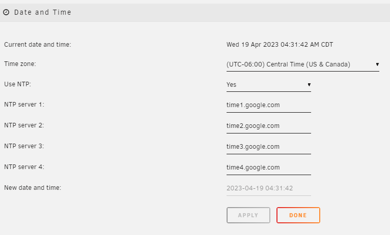

  2. The hours are not "incorrect", it was just a decision to use UTC, from now on. They were having problems with Daylight Saving Time, I believe. The UI will still be showing your configured time zone.
  3. Read my post. In short, it can't be changed. It's gonna be like that from now on.
  4. Not saying it's an issue or bug, just wondering is anybody knows how to change that. It seems the timestamp from the folders doesn't consider the time zone (UTC) thus + 5 hours for me. On previous versions this didn't happen. Gonna open a discussion there . Thank you. EDIT: Just for reference From Frigate 0.12 the folders are created in UTC by design and can't be changed. It's listed in the GitHub release notes. https://github.com/blakeblackshear/frigate/discussions/6165 https://github.com/blakeblackshear/frigate/releases/tag/v0.12.0

  8. Hello guys! I noticed that my recordings folder timestamp is wrong. it's 2023-04-18 > 11pm now. I'm in Central Daylight Time (GMT-5) Frigate 0.12.0 How can I fix that? Thank you!
