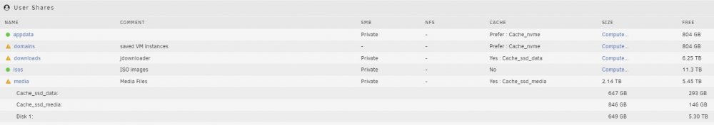

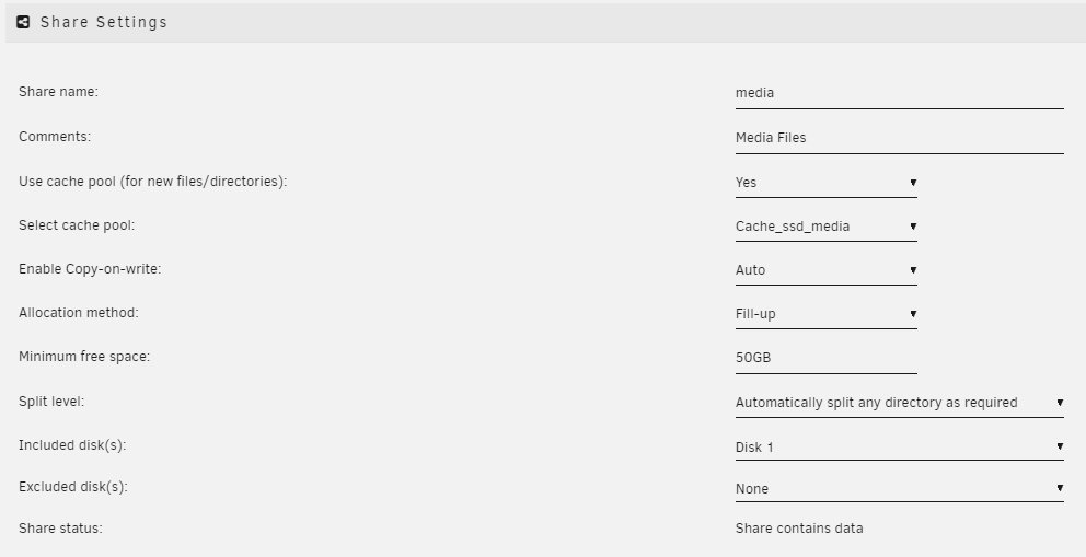

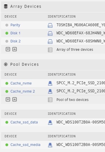

I have a share called media, it is set to use a cache drive named cache_ssd_media.  I also have an array of hdd's, it is set to use only disk1 in that array when the mover is called.
My issue is that I have another cache ssd named cache_ssd_data and for whatever reason unraid is splitting the movies, tv shows etc between the two cache drives.
I understood that all the settings under a share such as allocation method, split level etc handle how the data is handled once on the hdd array and has nothing to do with the cache drives, or, am I understanding that incorrectly?
I attached pictures to show the setup, you can see that the files in the media share are occupying two cache drives and disk1, I am not sure why it is using cache_ssd_data at all which I do not want.
My desired setup is media files on cache_ssd_media and when that is over 75% full and the mover is called they are then transferred to the disk1 hdd.

Update: Yup, I can confirm this behavior, I created two folders in the cache_ssd_data/downloads share, one named "moved with krusader" and one "moved with smb" and then moved them accordingly to the movies subfolder within the media share.
Using the shell to access each cache disk directly sure enough the krusader one ended up in cache_ssd_data/media/movies and the smb one ended up in cache_ssd_media/media/movies.
Well, at least I know why now, just have to move them all with SMB from now on I guess.
