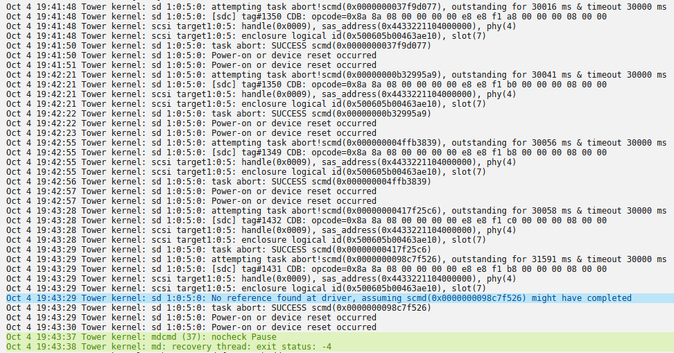

We stopped unbalance, removed the duplicate files using MC, tried to rebuild the disk and that's when we enter into a loop of rebuilding, drive going offline, doing a read-check, it passing, smart test's passing and then repeat.
Today whilst starting to do the rebuild once more before my freind replaces the drive all together, I noticed this in the logs:
Anyone have any ideas at all ?
Thanks in advance :)

The syslog snippet you posted earlier doesn't appear in either diagnostic since syslog resets on reboot. Looks like a connection problem. How is this disk attached?

Agree that it looks like a connection problem from the sys log snippet. The drive is connected to an LSI HBA, I want to say 9211, it’s definitely one that’s on the hardware list on the wiki, we were careful to check that.
There are 5 drives total connected to it and it’s just this one with issues. The power is connected by a molex-sata splitter, so could be an issue there perhaps ?
Check all connections, SATA and power, both ends, including splitters.
Try rebuild again and post diagnostics from rebuild attempt WITHOUT rebooting.

That combo makes me think too many drives on one power supply lead.
He’s had a move around of cables etc and is trying the rebuild again, so far so good !
