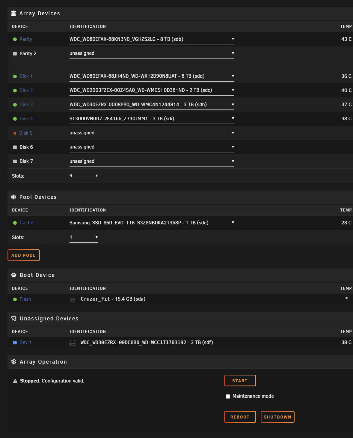

Ahh, great, thanks. So I clicked to add that disk to the array as disk5, but the page seemed to refresh and now the disk has disappeared (see attachment—I swear it was there a moment ago!). O.o
Fresh diagnostics posted. :S

Oct 18 19:19:02 Cube kernel: ata10: SATA link down (SStatus 0 SControl 300)
Oct 18 19:19:02 Cube kernel: ata10.00: disabled
Disk dropped offline, try replacing cables.
