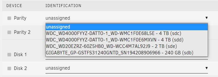

Not sure whether the diagnostics show this but these are my disks.
Does this give any indication of where each should be asigned?  I was wondering about the (sdb,c,d,e etc.) suffix.
Edited by Peter Holmes
You can use this process from the online documentation that can be accessed via the Manual link at the bottom of the Unraid GUI.
So what you did was a fresh install instead of updating from the webUI. Therefore, you had none of your configuration.
All of your configuration is in the config folder on flash. If you replace that with the config folder from your backup you should get your configuration back.
