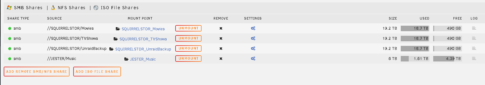

As far as your remote shares, three of them are showing 100% usage.  Is it possible that all 18T of space is used? This might be why they are having issues.  No room for new files.
//SQUIRRELSTOR/Movies         18T   18T  155G 100% /mnt/remotes/SQUIRRELSTOR_Movies
//SQUIRRELSTOR/TVShows        18T   18T  155G 100% /mnt/remotes/SQUIRRELSTOR_TVShows
//SQUIRRELSTOR/UnraidBackup   18T   18T  155G 100% /mnt/remotes/SQUIRRELSTOR_UnraidBackup
//JESTER/Music               5.5T  1.5T  4.0T  27% /mnt/remotes/JESTER_Music
I was looking at that, why is it using 41%? That seems like a lot.
And will the Docker template only show up after I delete it? Because there's not one stored in apps now and it kind of worries me about deleting the container.
And yeah unfortunately my NAS is pretty much full, but if it fills up it shouldn't disconnect and make all files stored there unavailable to Plex, it just shouldn't let me add anything new to it, right? Making all the files already stored there unavailable seems like strange behavior for running out of storage.

In the log, it doesn't look like the remote shares went off line.  I suspect that Plex had some trouble with the remote shares and couldn't deal with it.  Can you remove some stuff to provide more room?
You should review your container template and be sure the mappings are appropriate.  I suspect you have an incorrect mapping and are filling the container with files causing the docker container to fill up.

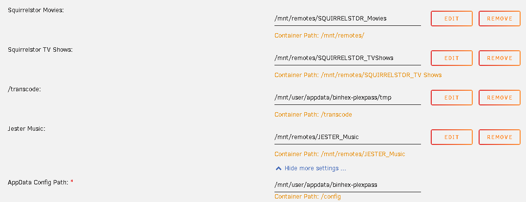

I'm having this weird problem now where stuff that used to play shows up fine in Plex but it just doesn't play anymore. The files themselves play fine, but in Plex it just wont play at all, the loading circle just spins.
All of my other dockers are "bridge" except my Binhex-Plexpass, it shows up as:
binhex-plexpass    host    192.168.15.187 ????
I also attached my maps from Docker and my mounts from unraid. I can browse the mounts in unraid just find, and the movies/shows show up as available now, Plex just won't play them.

What kind of a drive is your appdata share on?  Is it on the array?  Or on a cache or pool device?
You should transcode to the tmp file system for fastest transcoding.  Set '/transcode:' to '/tmp/transcode'.

Yes.  As I've explained to you before, you won't lose your configuration because it is on appdata.  That doesn't get removed, only the image gets removed and when you re-load the docker container you're right back where you started.  This is the beauty of a docker vs. a VM.  When you delete a VM you lose everything because the configuration and settings are in the VM.
I just reviewed your configuration to the binhex Plex template.  You've changed a lot of things and I think you have created yourself a problem.  The binhex docker template maps media to /mnt/user.  You've mapped stuff in the docker container that might not be appropriate for the binhex Plex container.  I suspect you are filling the docker container with files.
In your case just use /mnt/remotes/ for the media and then set it up in Plex for Music, VIdeos, etc.
I'm afraid you've created a situation that will need you to start all over.  Delete the docker vdisk and start over.  This time just map:
Host Path 2: to /mnt/remotes
Leave everything else to default

Alright, deleted the docker and the image file, and recreated it.
I have 3 maps so I could get everything to work:
    Host Path 2: container path is /media and host path is /mnt/user
    Transcode: container path is /transcode and host path is /tmp/transcode
    Remotes: container path is /mnt/remotes and host path is /mnt/remotes
/media is all my content on unraid, and /mnt/remotes is all the SMB shares I've mounted in the unassigned devices section.
All of my content appears to be accessible, although when I first clicked on browser from within Plex it told me it was inaccessible, and then displayed the contents. I haven't received that error again.
On the main page of Unraid under memory, I have 32gb, and it shows 41% is Docker. Is there a way for me to see what docker is using that much ram, or is it safe to say that it's Plex and that's normal?
Is there anything that seems out of place or incorrect in my configuration? I honestly don't know what the difference is between what I had and how it's set up now.
