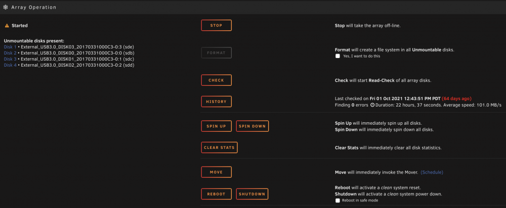

I clicked on the " new  config "  under tools, and didn't select any options.
I am now getting a message that the drives cannot be mounted. Did I miss an option or something I should have chosen?
I also understand that USB is not recommended, so my goal is to recover this RAID set and copy it to a new 12TB hard drive, then populate a mini ITX tower.
Thanks in advance for your help.
1597959922_ScreenShot2021-12-04at5_28_09AM.thumb.png.74b7368bf7128108acaf7f87a792751f.png
Likely USB related, please post new diags after array start.
"any options". Do you mean you didn't tell it to retain all assignments? Are you sure you assigned your disks correctly? Incorrect assignments wouldn't make all those disks unmountable, but if you assigned a parity drive to a data slot, it would be unmountable, and if you assigned a data drive to a parity slot, it would be overwritten with parity.
Your screenshot doesn't show it rebuilding parity, so you must have at least checked the box saying parity is valid.
