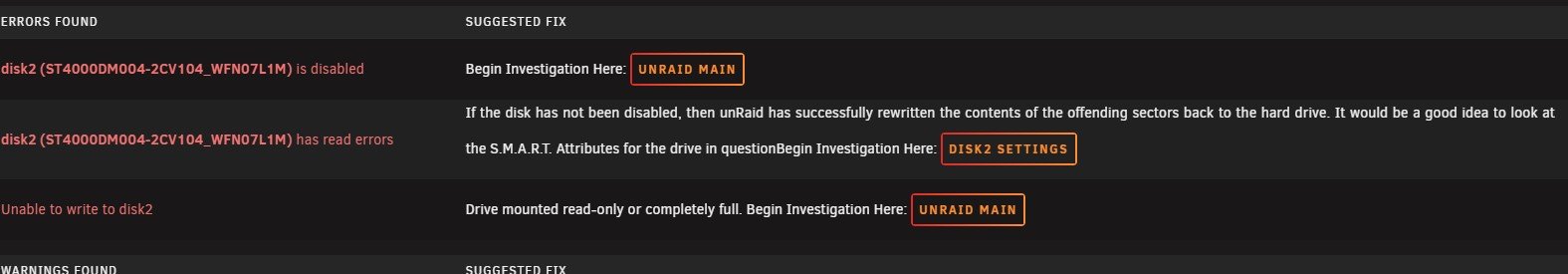

I'm not sure what you mean by spammed.  I ran an extended test in FCP and got what you see in the attached jpg.  Now the HD is disabled and contents emulated (I understand what that means).  The syslog does show those same errors you mentioned along with "Dec 22 07:15:01 Tower kernel: program smartctl is using a deprecated SCSI ioctl, please convert it to SG_IO".  I'm not sure what that means either.  How can I convert a drive to SG_IO?

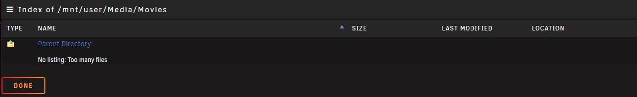

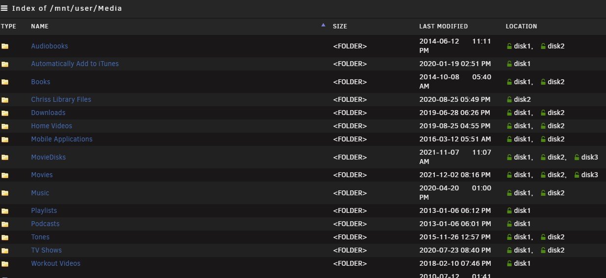

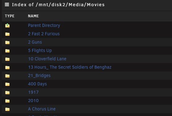

2.  The disk is showing the files but one particular share isn't showing the files in a specific folder.  It only show "No listing: Too many files".  But again those files show up on the disk in that specific folder.  How does the share have different views?
Could both issues be related?
