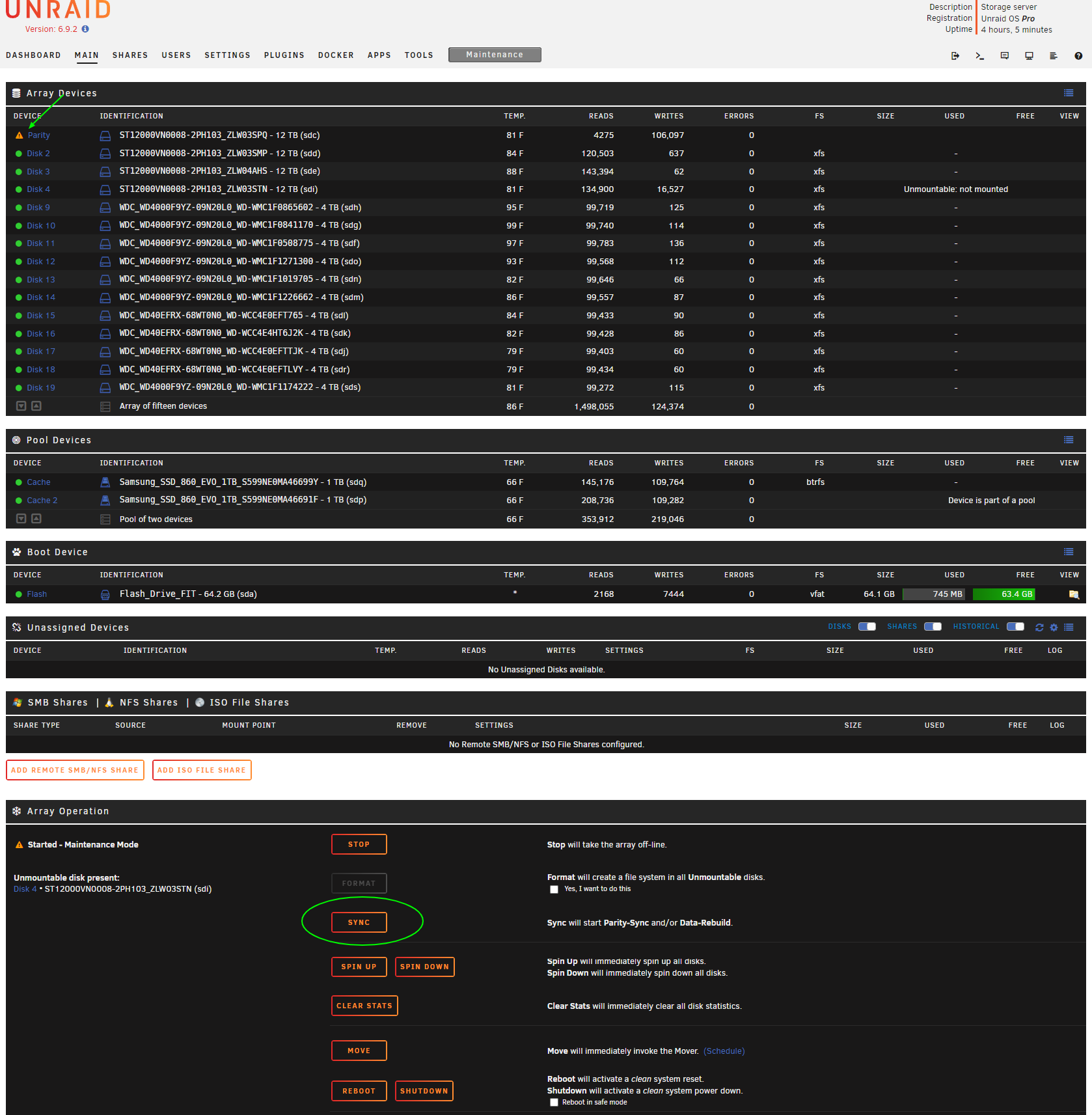

I'm trying to hang tight for someone more knowledgeable than me to offer some insight so I don't screw something up by going too far. But as I'm poking around with the array still in maintenance mode, I see an option called Sync that looks like it would fire a rebuild. I'm curious if that would help or hurt my situation. My Parity also shows INVALID now, but idk if that means invalid against the newly assigned array data and that it still has the old data in tact. I can confirm that before this the Parity was valid with zero errors.
I'll attach an image of the button I'm referencing...
Edited by joemama
It says your parity is invalid because you haven't rebuilt it after the New Config. And parity is in fact invalid since you removed disk20 from the array.
Why don't you have anything assigned as disk1?
Rebuilding parity only reads all the bits of all the other disks to get the results of the parity calculation and writes that result to the parity disk. So it will not change that unmountable disk in any way.
And, parity has none of your data even if it were valid. It just allows a missing disk to be rebuilt by reading all the other disks.
