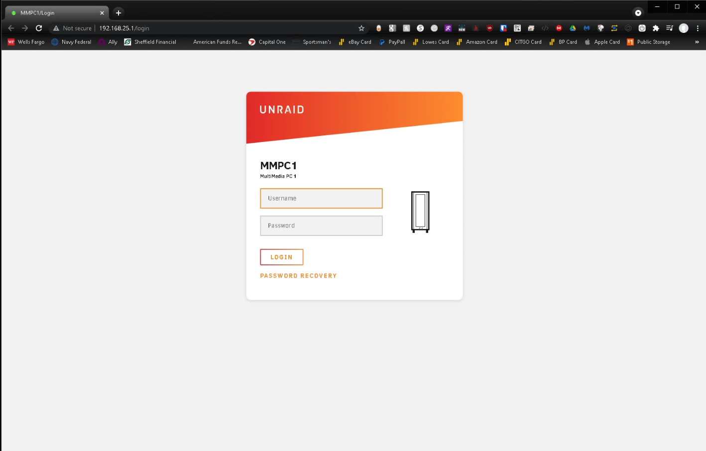

What's very intriguing is from VM I can actually access 192.168.25 network, but not from outside...  Is there a firewall block maybe???  I'm out of ideas....  UGH!
