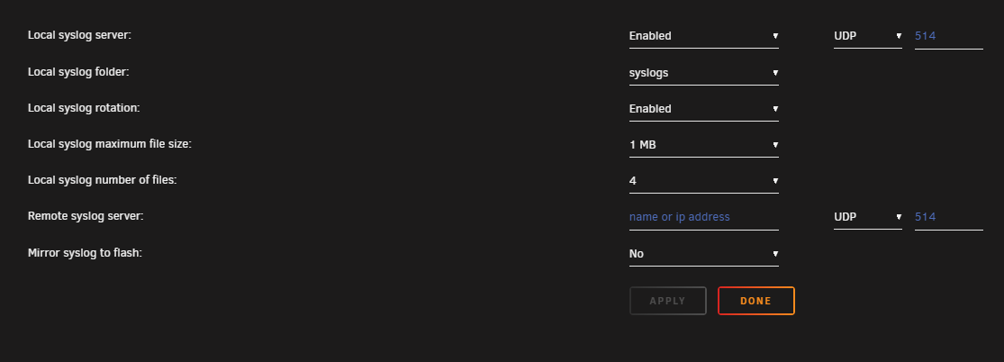

Have you setup syslog server?
Tried but UNRAID doesn't want to log at the place where I told it to write the files on my array
I just enabled them again.. Hopefully this time it doesn't disable itself but basically I have added a share called syslogs and the server is active and pointing to that share. Last time it disabled itself on its own.
Just out of curiosity, could the fact that I went with BTRFS for my array explain the issues I am having? Doesn't seem logical but just thought I'd ask just in case. Most seem to use XFS. That is why I'm asking really.
Edited by tessierp
Yesterday night I turned on the syslog server again. This time it didn't turn off, I guess last time it was a glitch. However, it has been well over 8 hours and nothing in the target folder.. I guess maybe I'm using it wrong?

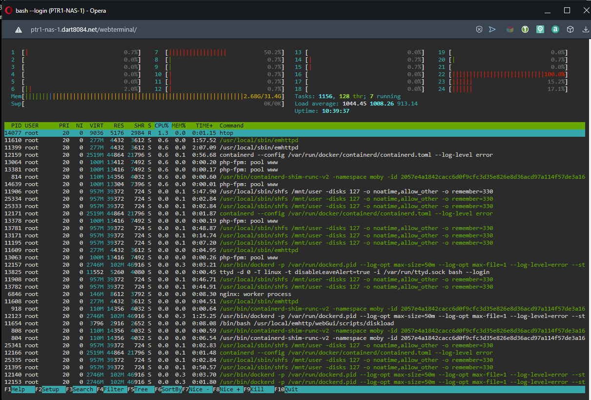

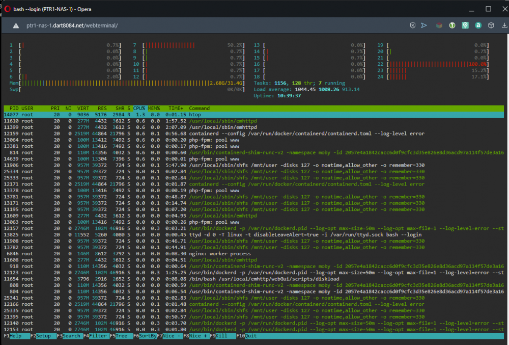

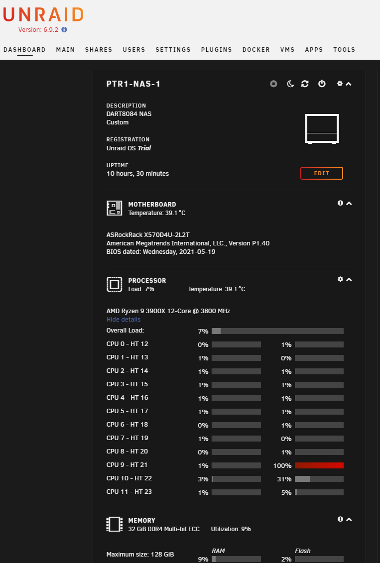

Alright, second time this happens... 1 core this time is 100%.. I can't stop my Plex docker container, can't download Diagnostics... I was able to download the syslog though.
Really not sure what is going on except that my UNRAID system has been extremely unstable.
Did a MEMTEST86 and no errors found... IPMI reports no issues with the motherboard.
Not sure if the devs are able to look into this because it does not seem like a hardware issue at this point.
Of course I can't reboot or shutdown, it hangs when I try too just like when this type of issue happened before with 1 core stuck at 100% (last time was 3). At least that is what the webUI reports. HTOP reports same core 100% and core 7 at 50%. It weird because the list shows CPU around 2%.... It is like some of the cores have been locked by something...
Eventually the WebUI become unresponsive. I had to connect a monitor and keyboard to login and ask a reboot. It waited 90 seconds for a graceful shutdown and it had to force a shutdown.. Now it is collecting diagnostics and hanging there.
Yeah.  Setting up a share means that's the share where another server will send it's syslogs to.  You wanted mirror to flash
If you do not want to mirror to flash then you can also set the IP of the Unraid server as the target (so that UnRaid is acting as both client and server).    This is what I prefer to do.
Never thought of doing that :)
