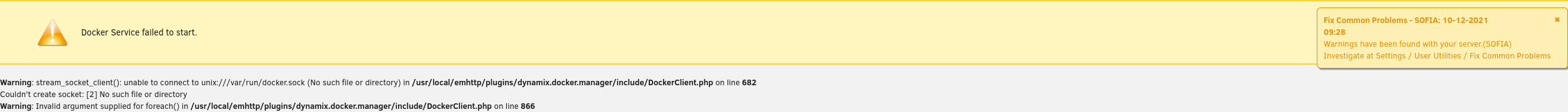

Docker Service failed to start.
Dear
please help
Until today, all Dockers were working normally
Suddenly I got a message.
What do you have to do?
I am not fluent in UNRAID
DockerClient.php

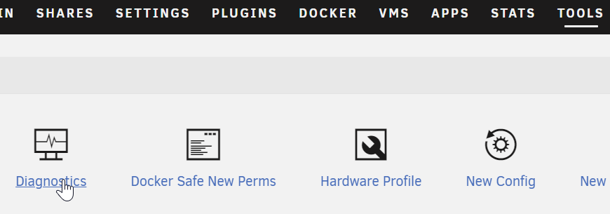

1 hour ago, Squid said:
Please post the diagnostics

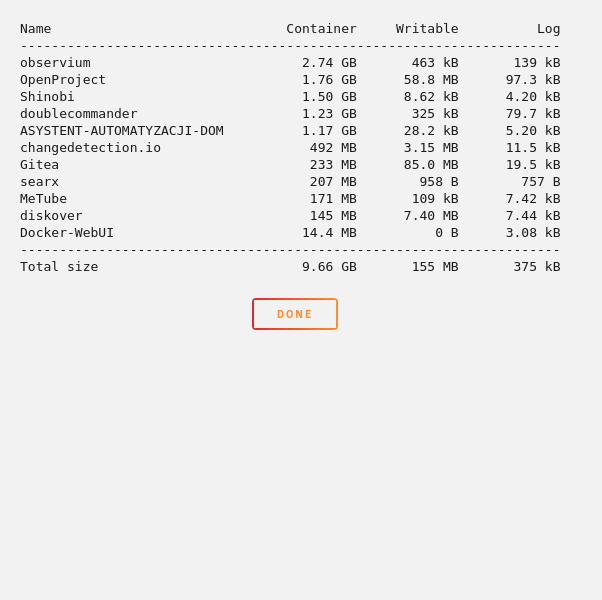

How can you track down what is filling up the docker.img??  Mine suddenly exploded for no reason.

On 12/13/2021 at 9:32 AM, trurl said:
The usual cause of filling docker.img is an application writing to a path that doesn't correspond to a container path in the mappings, case-sensitive.
Click the Container Size button on the Docker page and post a screenshot.
I may split your post and any replies to another thread since this one belongs to OP
That looks fine
