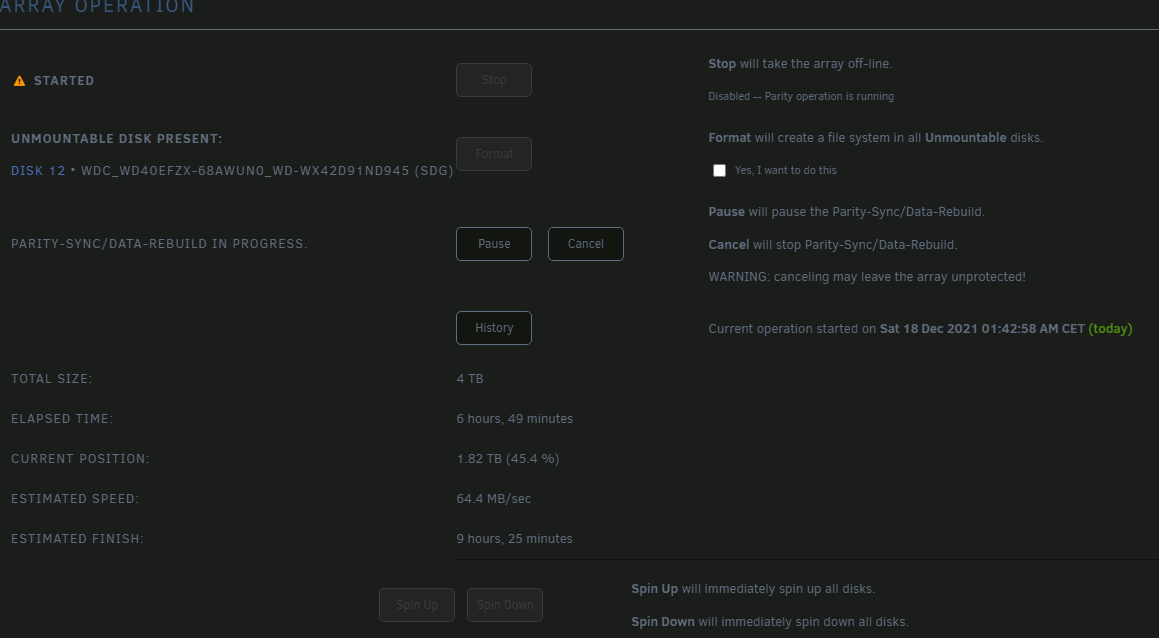

The rebulit is running:
UNMOUNTABLE DISK PRESENT:
DISK 12 • WDC_WD40EFZX-68AWUN0_WD-WX42D91ND945 (SDG)
Format will create a file system in all Unmountable disks.
 Yes, I want to do this
PARITY-SYNC/DATA-REBUILD IN PROGRESS. Pause will pause the Parity-Sync/Data-Rebuild.
Cancel will stop Parity-Sync/Data-Rebuild.
WARNING: canceling may leave the array unprotected!
Disk 12 is mentioned as unmountable. Will this be gone, when the rebuilt is done?
Disk 12 is shown as emulated.
This sounds like you have made a serious mistake. Format is NEVER part of rebuild.

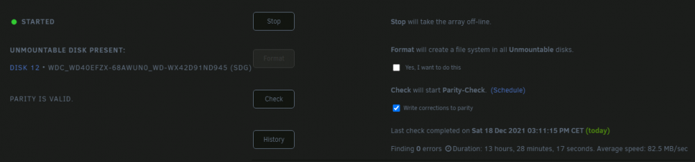

5 hours ago, shire said:
I haven't used the format button.
But you did start the rebuild? So you are rebuilding an unmountable disk. Usually we try to repair the emulated filesystem before rebuilding, but we will have to try repair after rebuild completes. Not really a big deal in this case since you are not rebuilding onto the original disk. So if there are problems with repair we can try to recover files from the original.
I startet the rebuilt, which is now done.
The array now shows this.
What should we do now?:-)
Edited by shire
Carry out this procedure against the rebuilt disk and report back on how it goes.
If I understand it correctly I should run:
xfs_repair /dev/md12
in maintenance mode.
The disk shows "auto" at the moment. Would that work?
Correct
