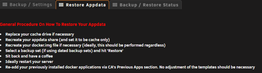

So my second cache drive failed too, luckily I made a backup 10 minutes before using CA Backup / Restore Appdata.

Have you then gone into Apps->Previous Apps and ticked off the containers you want re-installed into the new docker.img file?

That was the last step in the instructions that @Squid provided :)
When you do that step then Unraid will install the binaries for all the apps you tick off with their previous settings intact.
Thanks a lot sir, worked like a charm! Everything working fine now!
