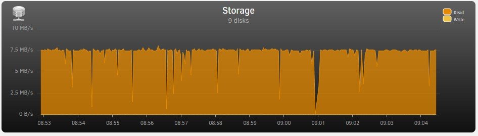

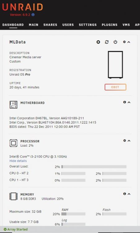

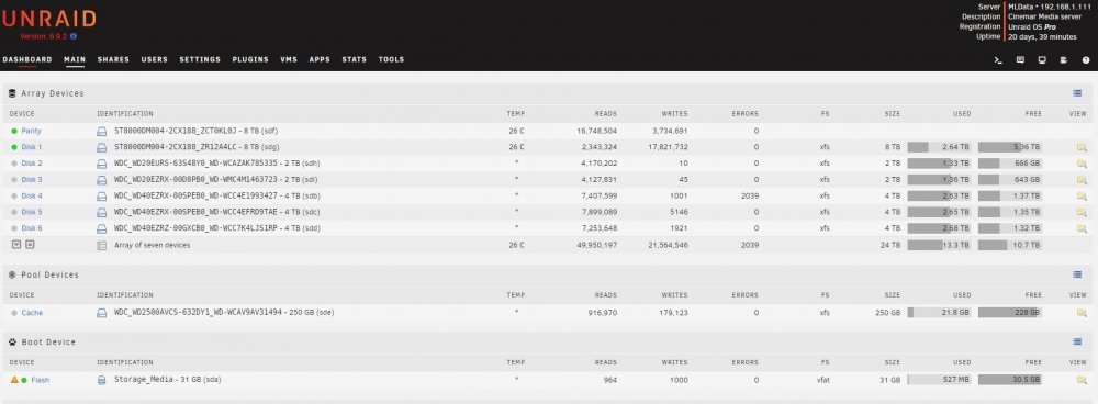

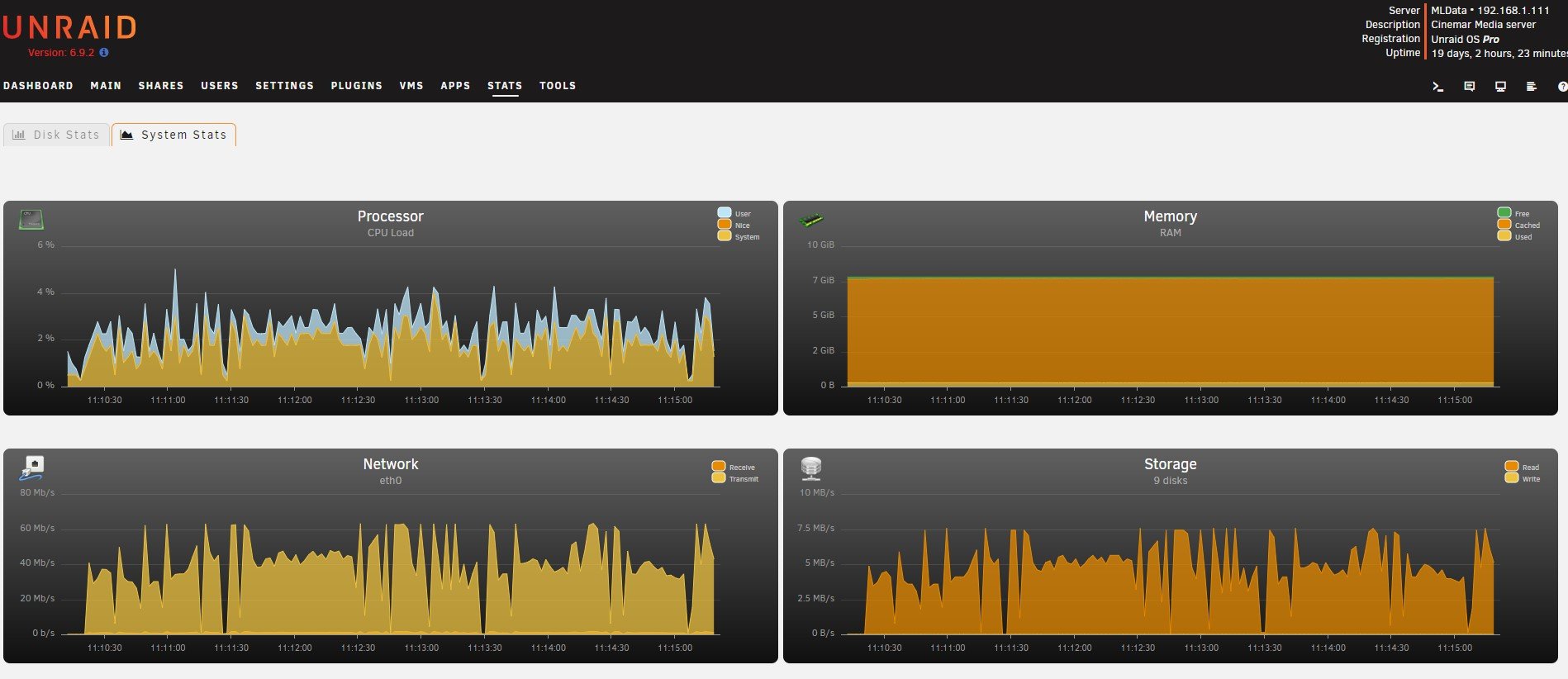

I'm having a consistent problem streaming ripped BluRay videos from my UnRaid setup, and I'm not really sure where to start.  This has been an issue for some time now but seems to be getting worse since installing the latest UnRaid OS.  It has mostly been simple audio dropouts in the past but now the video is stuttering which has made watching movies unacceptably bad.
My setup is an Intel i3-2100 dual core box with 8 drives connected via a Cisco switch to a Dune HD player.  UnRaid OS is 6.9.2.
When I copy a movie to the Dune's local HDD and play it from there, it performs flawlessly.  Via the network, however, the stutter happens about every 20-40 seconds (fairly random), corresponding with the dropouts in performance shown on the bottom two graphs:

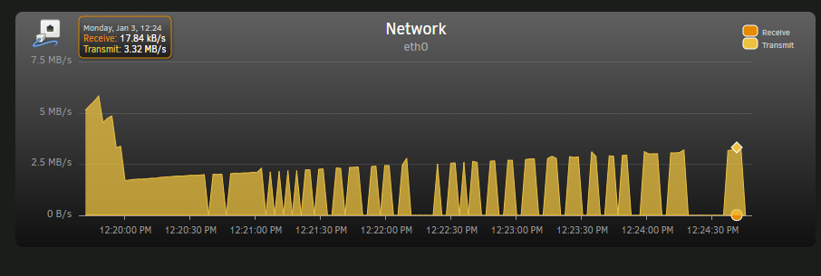

Obviously the Network and Storage graphs are highly correlated, and I'm assuming that the Storage is causing the poor performance, but I' not sure.
For storage, I have a mix of WD and Seagate drives, including two of the Seagate ST8000DM004 8TB drives.   I recently discovered that these are SMR, and I have one as the parity drive (I now realize this is not good), but from what I've read on SMR, it shouldn't be a problem for playback.  (I have a new 8TB CMR drive ordered to replace the parity drive, but I have a feeling that this won't solve my video playback issue.)
Thank you for any help or ideas on how I can diagnose this issue.
dashboard.thumb.jpg.d8540badfe23dc08351f0254c153c01c.jpgmain.thumb.jpg.55566f4043a98727a7f743cd7444f7d2.jpg
Solved by bonienl

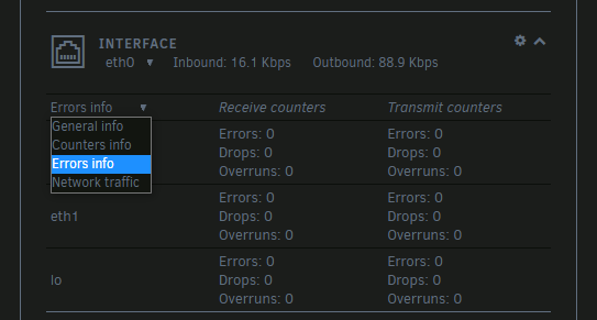

Pls also check
- Network port speed at Dune player was 1Gbps or not.
- Try VLC under PC for network playback.
- Check does abnormal found on network error info.
- I provide a graph FYI, btw it ceiling at ~4.1 MB/s during playback a bluray ISO.
Edited by Vr2Io

First, how do I get to the INTERFACE statistics screen above?  I can't find that.
Next, I don't know how to tell about the network port speed on Dune.  Today I turned on "experimental 1Gbps" mode on Dune, but that doesn't seem to have had any effect.

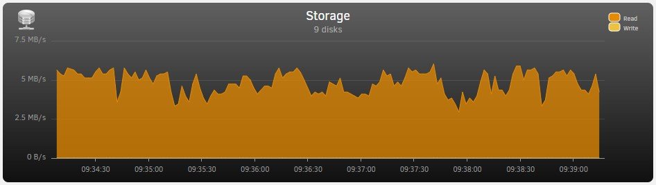

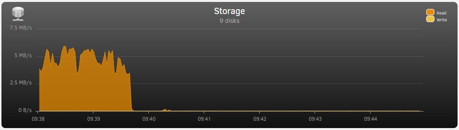

VLC:  I downloaded VLC on a server attached to the same Cisco switch and played the same movie.  Video was not smooth; I'm assuming that the server was having to do some soft transcoding.  Here's the storage traffic during that time:

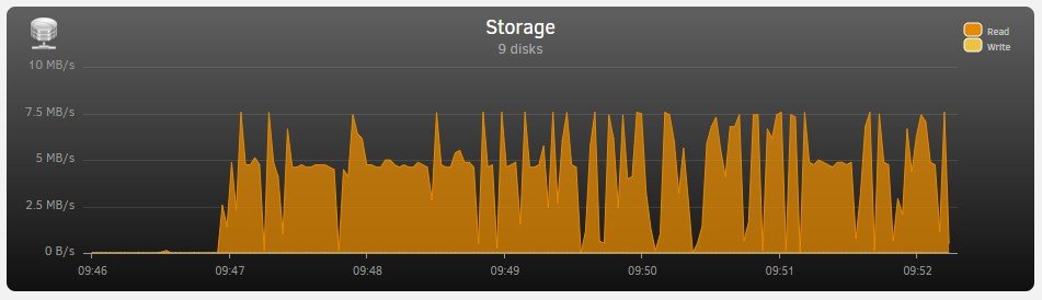

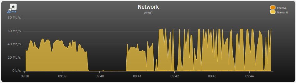

For comparison, here's the storage traffic during a copy of a different movie from UnRaid to Dune's local HDD.  Note similar dropouts in performance:
Here's the network traffic during a subsequent play of the same movie right after the VLC play.  Note the significant dropouts:
And here's the associated storage traffic.  I'm assuming that the NAS box was sourcing the movie from cache, since it just played on VLC 5 minutes before:
And here's storage traffic playing a different movie (to get past the caching issue).  Same (or worse) stuttering problem:

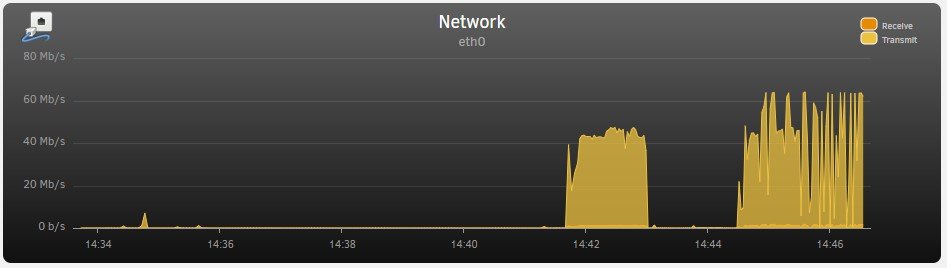

Okay, so with my new understanding of bitrate, I searched through my various movies and found one with a bitrate of 43Mbps (which seems to be one of the highest in my library).

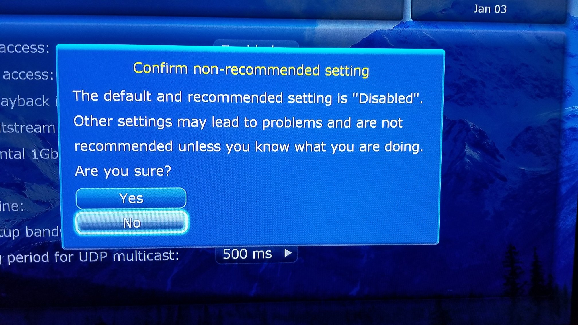

Along with trying to play that file, I also was curious about the "Fast SMB access" setting within Dune:
I have always kept that disabled, as enabling it comes with a strong warning about "you shouldn't do this if you don't know what you're doing" (which I clearly don't!).  Curious, though, I tried enabling it... with good results:
The cluster of network traffic above 14:42 is with "Fast SMB access" enabled.  The right cluster is with it disabled.  And video playback is correspondingly great with it enabled and unwatchable with it disabled.
So, I will now enable this, needless to say.  Does anyone know what "Fast SMB access" might mean?  As mentioned previously, their documentation is pretty poor.
SMB has several versions (SMBv1, SMBv2, and SMBv3) There is a big difference between the earliest versions and the later ones as far as the reduction of Protocol overhead required.  And the later versions sometimes had problems with systems that only supported the earlier ones back at the time of transition.  These were usually resolved over the years.  I can recall if you said how old your Dune box was but I have Netgear NTV-550 which still requires SMBv1 which is still supported by Unraid.  (MS has turned SMBv1 off but if you know how, you can still turn it on...)

I have been using Dune media players since 2009, and they work wonderfully.
The older models had only fast ethernet (100Mbps) connection. Dune uses their specific algorithm to read files from SMB, this is used when you enable “fast smb access”. Btw this setting does not exist anymore in nwer versions, which are optimised by default.
The graphic shows a constant reading (left) vs a lot of fluctuation (right), the latter part explains your stuttering.

It seems like this is really a necessary feature to enable.  I wonder why they label this "not recommended":
Edited by cowger
add warning picture
