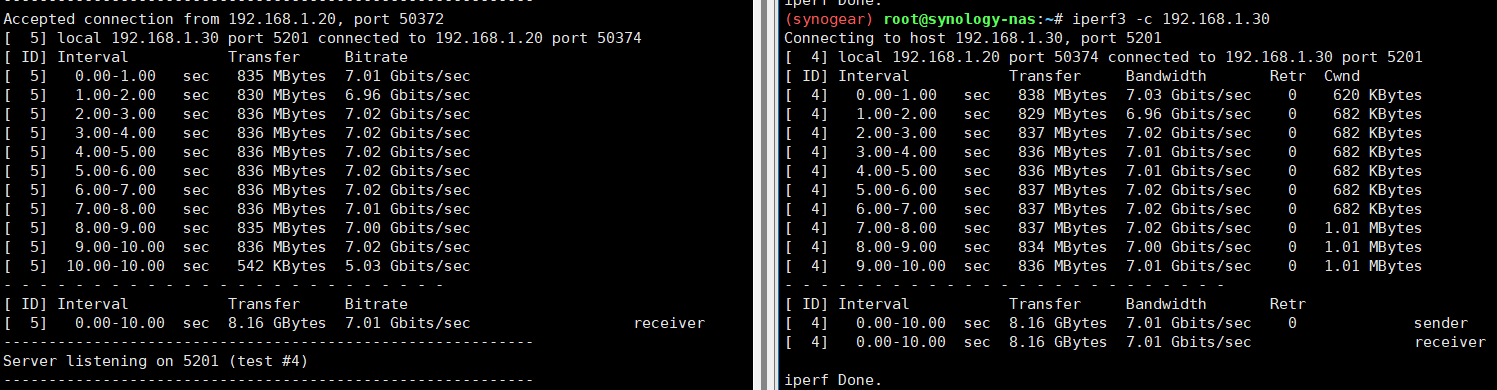

I am doing some troubleshooting with AsRock Rack and the X570D4U-2L2T and abysmal throughput performance under the latest 6.9.2 and 6.10 RC2 release. One question that is of course being asked is what driver am I using, and the basics I know are we are using the in-tree driver for what seems to be the 5.14.15 kernel. The board has built in dual Intel X550 NIC's, which I have disabled for the time being and am using an older X520 add-on card which works perfect (same driver).

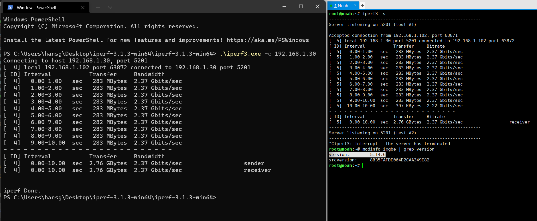

How can I tell what version of igxbe is actually installed and loaded? I did some basic digging in syslog and didn't see anything other than calls outs to ixgbe driver being loaded, but no version.
This is the closest I have come, and it's still not what I need since there is no actual version number:

In my work with AsRock currently, is there any idea what "version" the current "in-tree" driver is, let's say for the current RC3 release which seems to be using the 5.15.27 linux kernel, is there some command I can run to pull a version string or revision number from it? Or is it really just an unknown?

'modinfo ixgbe' is supposed to but I see for some reason it's not output.  I do know this driver seems pretty old.

@limetech thanks for including the latest out of tree driver, so far so good with a basic test using a 2.5Gb nic. Tomorrow will test more in depth with 10Gb, was just too excited to wait:
Edited by cybrnook
@limetech
Just wanted to say thanks again, all seems to be working well. Got some tuning to do on my side, switch level, but all seems to be within spec. Seems it was the driver....
