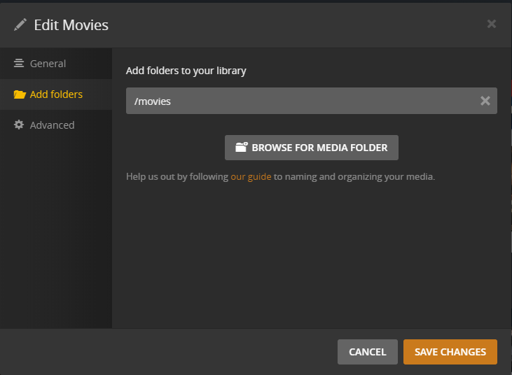

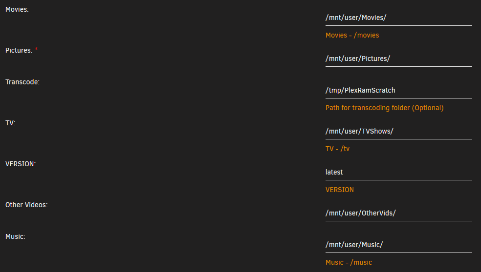

Both of the share structures you mentioned are very common.  I use the first with a share for each media type (Photos, Movies, TV Shows, Videos, Music, etc.)
I personally like to organize things this way and then I set up a path for each share in Plex docker container (/movies is mapped to /mnt/user/Movies).  These paths are then mapped to a Library type in Plex (Movies library mapped to /movies).
This is my personal preference only.  Other prefer a single Media share with sub-folders for media type.  I like just going directly to the appropriate media share.

Setting up Plex now and want to retain my existing separate share structure, with Television and Movies shares. The question I have is how to fill out the Host Path 3 entry on the template. This would, in the normal setup, be the top level media directory.
Any thoughts or help?
If you use /mnt/user, Plex will have access to all user shares
