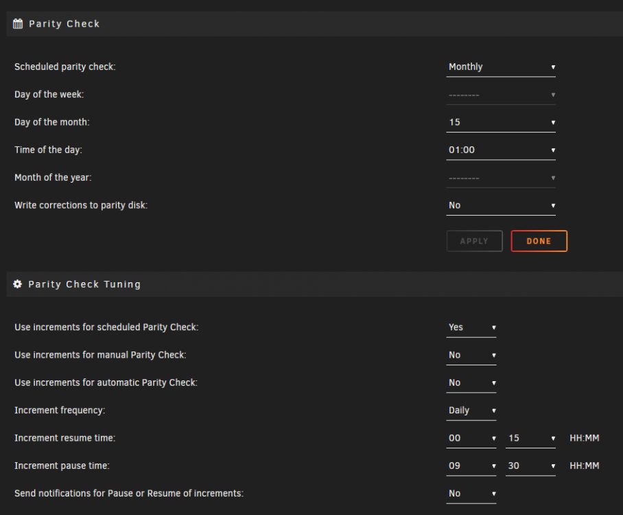

It also looks like the Parity Check Tuning Plugin replaces the scheduler Plugin (or the core unRAID Scheduler function - I can't remember if I had to install this separately) as when I go to Settings - Scheduler I see the Parity Check Tuning Plugin.  Is that correct?
Yes.  They work in conjunction with each other.  Scheduler - Parity Check tells the system when to start it (eg: Monthly)   Parity check tuner tells the system when to pause it and when to resume (ie: next day at whatever time you want and for what duration...)
It is in addition to unRAID core Parity check scheduling.  You still set the schedule for parity checks through the unRAID core functionality and fine tune the increments through the Parity Check Tuning plugin.  Here is my configuration for once a month on the 15th with it running from 1:00 am to 9:30 am, pausing and resuming again at 12:15am.  It finished for me on that second increment before I start my day on the 16th.
