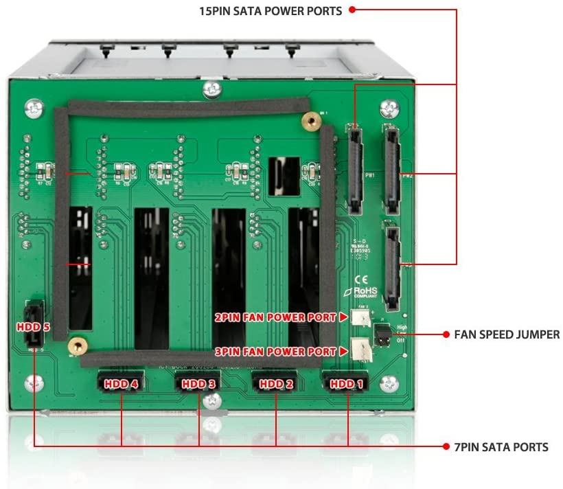

It seems the fan on the back is flat against the PCB
I think that's on purpose to ensure that the air comes from the drive area, not from the interior of the case.
There are openings in the PCB to pull air from the outside, between the drives.

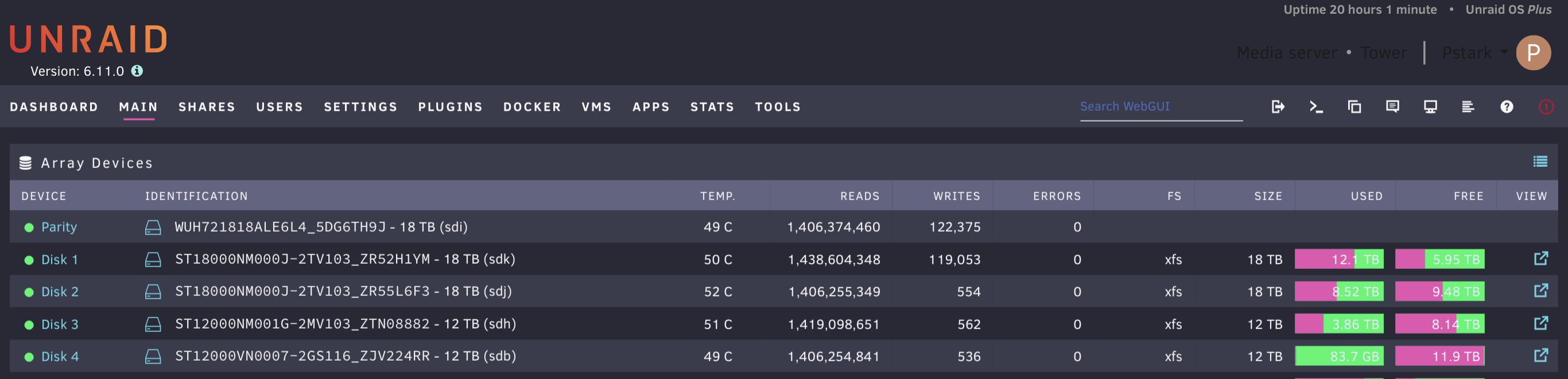

I have 4 out the 5 bays filled with WD Red HDD's. I have a 5th drive but haven't installed it yet. When I installed the 4th drive, I decided to pre clear all the drives as I'm putting this together piece by piece. The system also doesn't have any data on it yet either. The reason I'm asking about these drives getting hot is because Unraid notifies me that they are getting hot. I'm not sure what the critical temperature is for HDD's but according to Unraid, they are hot. With fans on "HI" temps were around 40c which is acceptable but when fans are on "MED" or lower they are 48-49c. With the unit having a fan, I just thought I would wouldn't have to worry getting a high temp notification.

Yes, I tried this and didn't work for lowering temps so currentlyI have it a 120mm fan in front pushing air into it and the 92mm still in back pulling. While this keeps the HDD temps a lot lower, it's just inefficient. I just ordered a different 92mm fan I'm going to see if it works better and hopefully won't need the fan in front. I ordered a be quiet pure wings 2. I also got a Norco SS-500 and it keeps the temps at the same level with just one fan in the back. The Norco has better airflow than the Icy Dock but then again, I'm not using these in a case as they're intended.
I installed a Pure Wings 2 92mm fan in the rear yesterday and on the high fan setting these are the temps during a parity check. They are better than the fan that came with the unit. No fan in front anymore so just the single 92mm fan now. I might recommend a noctua instead if noise isn’t a concern but the Pure Wings 2 is virtually silent which is a plus.
