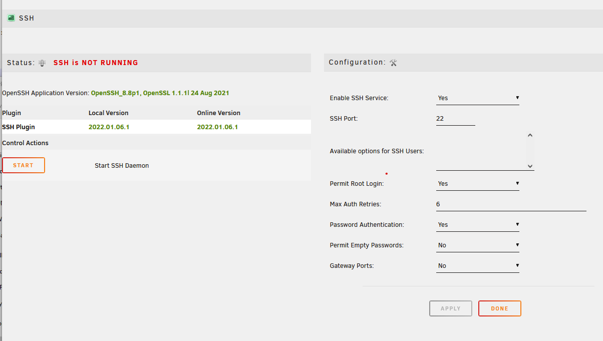

NoOneAtHome Posted January 31, 2022 Share Posted January 31, 2022 (edited) Hello all. For reasons I do not understand SSH does not seem to be automatically starting at boot. my ssh files are NOT zero root@OuterRim:/boot/config/ssh# ls -la total 96 drwx------ 3 root root 8192 Jan 30 11:41 ./ drwx------ 10 root root 8192 Jan 30 20:05 ../ drwx------ 2 root root 8192 Jan 30 10:58 root/ -rw------- 1 root root 1373 Jan 30 10:58 ssh_host_dsa_key -rw------- 1 root root 600 Jan 30 10:58 ssh_host_dsa_key.pub -rw------- 1 root root 505 Jan 30 10:58 ssh_host_ecdsa_key -rw------- 1 root root 172 Jan 30 10:58 ssh_host_ecdsa_key.pub -rw------- 1 root root 399 Jan 30 10:58 ssh_host_ed25519_key -rw------- 1 root root 92 Jan 30 10:58 ssh_host_ed25519_key.pub -rw------- 1 root root 2602 Jan 30 10:58 ssh_host_rsa_key -rw------- 1 root root 564 Jan 30 10:58 ssh_host_rsa_key.pub -rw------- 1 root root 3415 Jan 30 20:05 sshd_config no ssh process seems to be running root@OuterRim:/boot/config/ssh# ps aux |grep ssh root 26789 0.0 0.0 3984 2224 pts/0 S+ 20:12 0:00 grep ssh I installed the SSH Config Tool and it sure enough shows SSH Stopped If I click Start on SSH Config Tool SSH starts and the service is accessible but it does not survive reboot I am unsure of the proper way to make sure SSH starts at boot. Any help is appreciated,thanks Edited January 31, 2022 by NoOneAtHome Quote Link to comment
Squid Posted January 31, 2022 Share Posted January 31, 2022 Is SSH enabled in Settings - Management Settings? Also if issues with this continue, then uninstall that plugin and try again with just the base OS to see if SSH works Quote Link to comment
Solution NoOneAtHome Posted January 31, 2022 Author Solution Share Posted January 31, 2022 Yes it is enabled. I installed the plugin after I started experiencing the issue. Since this is a fresh install, and I am eager to get it going, I just created a new USB and no longer having the issue. Quote Link to comment
