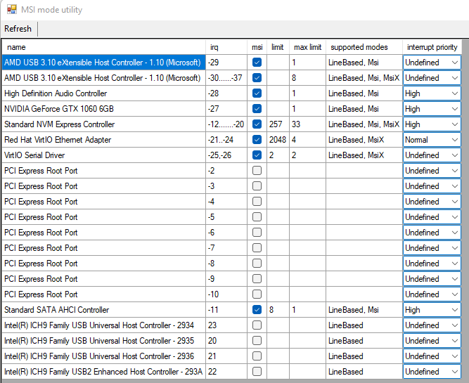

On 2/9/2022 at 6:48 AM, Cliff said:
Is this also related to MSI ?
It should not..but who knows..from your screenshot only the 4 intel emulated controllers are using irq, all the other devices are using msi, so it's not an issue with irq.
However msi for some devices can be problematic.
Not much to say unfortunately, but if I were you I:
1. disable all msi fixes and see if it changes something
2. if it doesn't change, remove all the passthroughs, except for the nvme (you have the os on it), so remove gpu and usb, and see if it changes something
3. if it's ok add again one at a time the other passthrough, first gpu, then usb, and see if it works
4. only if you have issues in the vm for specific devices (usually gpu and audio, sometimes with network), enable msi, you don't need to enable msi for all devices, having shared irq can be perfectly fine, as it is also in several bare metal builds
Thanks for the tips, I tried your steps and removed all passthroughs but the nvme and created a new Win11 VM. I had some strange issues where I could not create any VM using Q35 for some reason but after changing to i440fx I was able to create the new VM. So this time I have only stubbed the nvme and the usb-controller and my VM is usable again. My CPU dpes not spike to 100% any longer as it did before but I still have the issue that when I move the mouse rapidly all cores increase with ~15-20%.
Should I try to stub the gpu again or do I need to enable msi on the usb-controller or is there some other steps I could try to eliminate the cpu load when using the mouse?

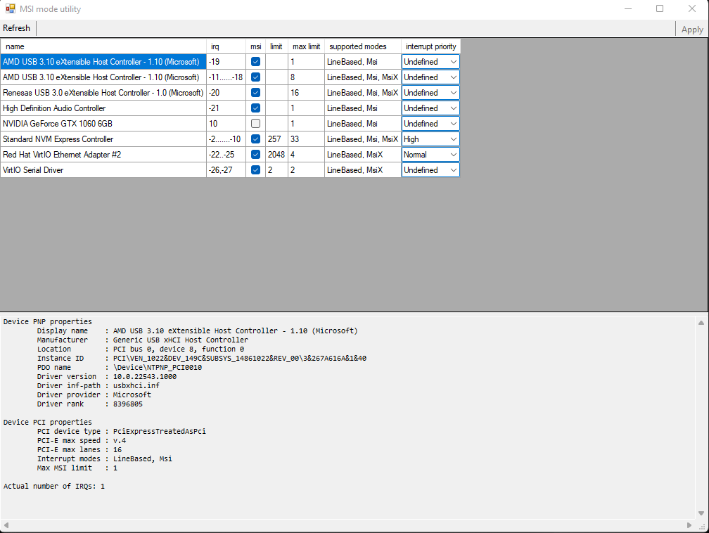

First try to fix the mouse: can you attach without enabling msi a screenshot of the msi util?
This is how it looks now, I have not enabled anything myself in this vm but I do not know if any of my previous msi settings is still applied from my previous vm.
Is this a completely new install?And it's this one that has 15-20% spikes on cpu with fast mouse movements?
It seems strange because usually msi is not enabled by default.
There's no irq sharing here, but the issue could be related with msi.
Where is your mouse attached?You could try to uncheck msi for the usb controller to which your mouse is attached.
It works like this:
in the irq column if you read a number with the minus in front of it, it is using msi.
in the irq column if you read a positive number it is using irq and the interrupt priority column applies.
in the irq column if you read positive numbers, and you have the same positive numbers for different devices, then there's an irq conflict: depending on devices you can enable msi to avoid conflicts.
linebased means irq, msi/msix means msi compatible (msix being a "more recent version" of msi)
Usually it is not recommended to enable msi for all the devices.

Ok, thanks for the information. I have always created the VMs unsing the passed through nvme as hdd so I always use the same windows install if even if I create a new Win11 . I am passing through the entire usb controller as I am using a usb kvm switch to switch between my work-computer and my private (The windows 11 vm). And If I did not pass through the entire controller the vm would hang when switching between the computers and it lost all usb input devices. And yes this VM spikes 15-20% when moving the mouse. Ok so I should disable all msi checkboxes for now ?
Edited by Cliff
Try to uncheck all, reboot, look at how devices are arranged about irq, check if you still have spikes, enable msi for conflicting devices (if any) or post the new screenshot.
Edited by ghost82
Ok tried disabeling all msi, rebooted and now it is unusable again it took 5 minutes to boot, only one monitor works (I have three) and I did the mistake of trying to open chrome and now all cpu cores are at 100% and the VM does not respond. I will try to force shutdown and only open the msi-app. But what devices would be the best bet to enable again to get the VM to work again ?
In order, in my opinion, and only if there are conflicts:
- gpu video and gpu audio
- nvme/sata controllers (take care with this, in some cases enabling msi on these may result in unbootable systems)
- network
- usb
Edited by ghost82
