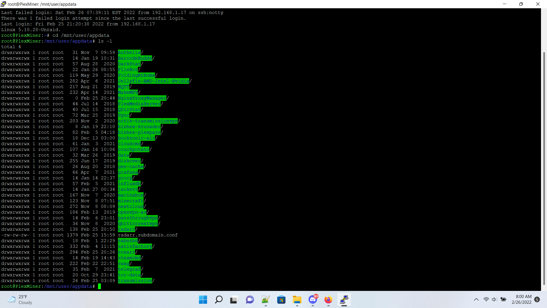

I seriously screwed up and ran new permission on my appdata folder which resulted in all my containers now having "execution error: bad parameter" and not running.
My last appdata backup was unfortunately almost a year ago. How do i go about fixing this so i can have my containers work again?
EDIT - created a new thread below describing what i did to fix the issue.
