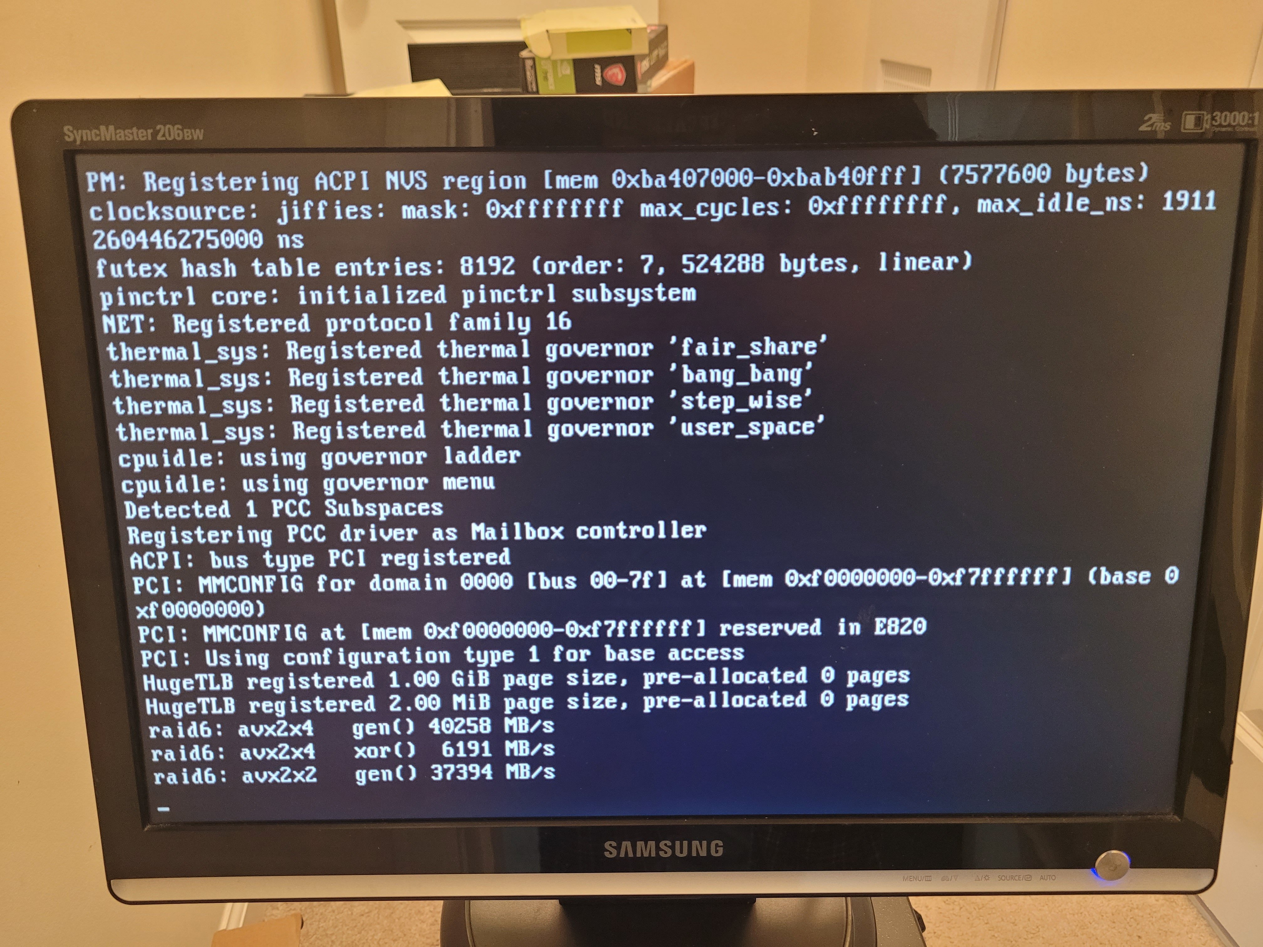

Switching to legacy "helped" a little
I can now see more of the loading script but the PC still crashes.
I was able to take a picture on what was the last message on the screen before the PC restarted
