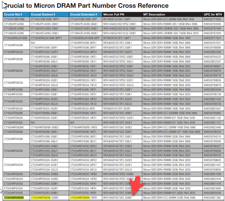

March 29, 20224 yr Author On 3/19/2022 at 1:05 PM, Vr2Io said: You can, but non-XMP usually in 2133, you need manual set to 2666. If upgrade both RAM and CPU, I would wait a new gen DDR5 platform. Thanks I finally found the right RAM as the supported ones but in 32G modules Seems that the Crusial RAM for servers anyway with ECC is now named Micron So I can do the upgrade with what should be supported RAM This new gen DDR5 would that be Intel Xeon? I havent seen anything on this, so it could be a very long time before we get this? I have some very BAD memory problems:

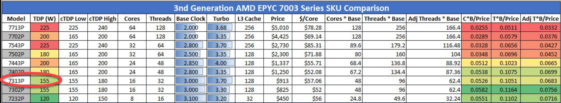

April 10, 20224 yr Author Thanks Vr2lo I really want to keep using ECC RAM but I would like to get the 3200 for the EPYC looks like the power usage is better vs performance My list so far: Power usage acceptable (OLD CPU TDP 80W - new EPYC one 155W-180W?) CPU Benchmark single thread minum 2000 10G bit LAN (2x10G) 7 x PCI slots - 128 lanes ECC !!!! - Min. 128G RAM 4-8 channel possibility to upgrade to MB: 256G Ram CPU Xeon 12 Cores 5 gen or AMD EPYC 16-24 cores? CPU air cooling 4U server rack Bifurcation motherboard Intel GVT-g (Only Intel?) Thunderbolt support USB-C Remote Management (IPMI) I think this would be a viable solution for a new Unraid server next 5 year ASRock ROMED8-2T CPU: AMD EPYC 7313 Benchmark: 40575 Single thread: 2610 (I would like to keep the existing single thread performance = Intel’s Xeon E-2176G) Memory: 128 GB Registered ECC RDIMMs (4x32 GB) Kingston KSM32RD4/32MEI @ 3200Mhz (Per Memory QVL) CPU cooler Noctua NH-U9 TR4-SP3 (Should fit my existing Norco RPC-4224 4U) I have read that Bios and the configuration of this board could be a challenge but that it works well with Unraid? Anyone who is running Unraid with this MB and a EPYC CPU? Edited April 10, 20224 yr by casperse
