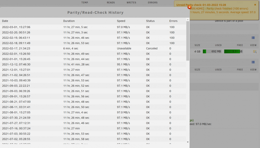

Unraid 6.9.2 Parity check finished, 100 errors
Unraid was working without problems for a number of years. Suddenly I had "Parity check finished (100 errors)". Below is history of parity checks and diagnostics attached. I don't want to do anything silly, so thought it's better to consult experts on the forum.

Check connections on disk2 then disable spindown on disk2 and run an extended SMART test. If that passes you need to run another correcting check.
Then a non-correcting parity check to verify. The only acceptable result is exactly zero sync errors so you have been in an unacceptable state for several weeks now.
You should have seen the I/O errors for disk2 in the Errors column on Main - Array Devices. Check to make sure you aren't still getting them when you correct parity again.
