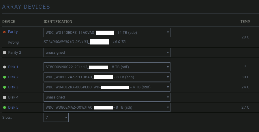

Quick one from me, I stopped the array to add a new data disc and for some reason unraid unassigned my WD parity disc from the array and wants the old Seagate disc back in. When I go to add the WD disc it wants to rebuild the array again.
My server only just completed a parity check last night with the WD disc in and has been running with this parity disc in for about 2 weeks so I know it was built correctly.
I take it there is no way around this but to rebuild the whole thing again? More want to understand why it unassigned itself in the first place to prevent it from happening again.
Thanks

Apr  4 08:44:44 HomeServer kernel: sd 0:0:0:0: [sda] tag#0 UNKNOWN(0x2003) Result: hostbyte=0x00 driverbyte=DRIVER_OK cmd_age=0s
Apr  4 08:44:44 HomeServer kernel: sd 0:0:0:0: [sda] tag#0 Sense Key : 0x3 [current]
Apr  4 08:44:44 HomeServer kernel: sd 0:0:0:0: [sda] tag#0 ASC=0x11 ASCQ=0x0
Apr  4 08:44:44 HomeServer kernel: sd 0:0:0:0: [sda] tag#0 CDB: opcode=0x28 28 00 00 ee cf 00 00 00 80 00
Apr  4 08:44:44 HomeServer kernel: blk_update_request: critical medium error, dev sda, sector 15650560 op 0x0:(READ) flags 0x80700 phys_seg 1
Problems with the flash drive, and likley why the drive changes weren't recorded.

8:44 is when the system was roughly restarted after an update. I updated the system since the array was offline anyway and was trying to figure out what was going on. Thinking i intially took the array offline about 8:15. I tried looking through the logs but couldn't see anything before this time. Are the logs wiped after a restart?
Yes (unless you have activated the syslog server).
Well, i'll probably never know then unfortunately.
Thanks for the help anyway!
